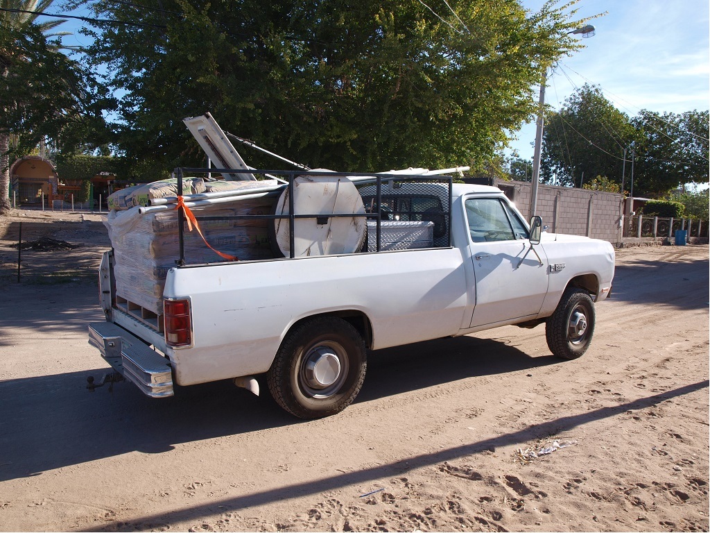

. I only had to go about a mile, but I was sweating bullets the whole way. The hardware store could not deliver it until the next day and I was paying 5 or 6 workers, soooo I said load 'er up! They said how many? I said why all of it of course.

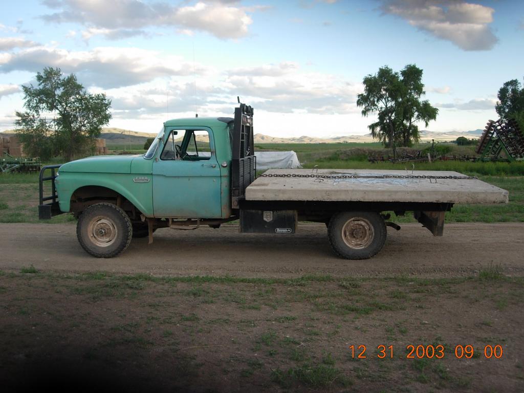

This isn't even the worst, I hauled a ton of floor tiles 60 mile during the house construction saga. these are bad ax trucks...
...MarkP.S. I still had spring left in the rear suspension...
