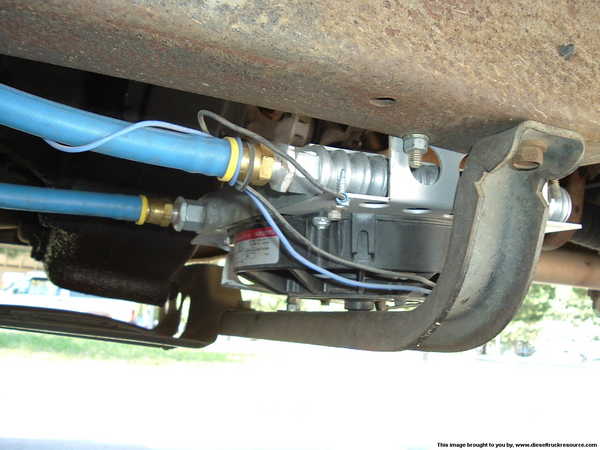

This is the one I got from Summit.com I really is amazing how much cooler the engine runs with this thing running. I had a local hose shop build the 1/2" 8an lines. I do need to do a better wiring job on it but it is working good for now. This is how I mounted it. This is parker high temp hose rated at 300F continuous temp with petrol based oil @250 working psi and 1000 burst psi. The IC radiator would be a big help also.

Hey man, Thats a handy little cooler do-dad. I believe I will get one for myself.

Yes it is 13000 not 1300 . I have tried to locate the manufacture of the unit you showed me with no luck. I tried summit.com with no luck. Can you point me in the rite direction?
