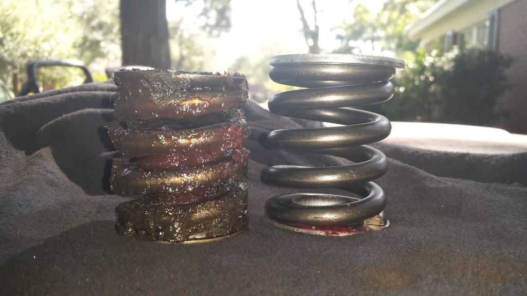

just wanted to add a little tip/trick I learned from an old school off roader I met many moons ago. this is how he explained it to me and I've been doing it this way ever since.
if you have a worn out dana 60 in a first gen, you know about death wobble.
well this frugal older gentlemen showed me that taking the upper kingpin cap off and throwing a few washers on top of a worn out spring will fix death wobble for about $0.50. He also told me that adding 1 thick washer to new springs adds some preload to that spring and really tightens up your kingpins.
I had real bad death wobble on my 1st gen. replaced the springs and bushings while adding a thick washer to the top about 12,000 miles ago and it's still death wobble free! here is what a worn out spring looks like next to a new spring with a washer.
I would think that is a good idea to get by until new springs can be installed. I had horrible, loss of control death wobble that hasn't returned with job described above in this thread. Your experience does show that the springs getting weak are a major reason for DW...Mark
