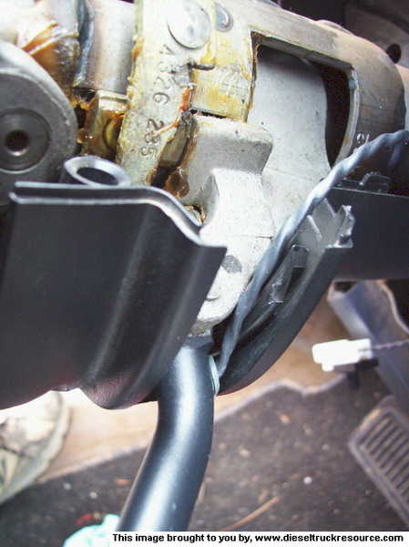

I installed the new shifter but it looks like there's clearance problems between the wire and the steering column covers. The wire lines up with the track for the sliding plastic closure piece - or whatever you call that! How do you route that wire to clear everything.

There's a picture in my album that shows the clearance problem. For those of you who have done this mod. are you not having this problem? Seems like the insulation on the wires would wear through and the wires would short out? BTW, it does work, I just don't have the covers on.

Thanks to whoever posted the pic for me! For some reason my javascript isn't working so nothing outside the text box works. Think it was a McAffe or HP or Microsoft update that caused the problem?
So, how do I get that wire to clear? Are there some different column covers?

Is the picture with the shifter in 1st? I didn't modify anything but I also don't remember the wires being an issue.
Won't they tuck in closer to the column under the bottom cover and let the little plastic cover slide over the top of them?

Looks to me that you might want to pull the lower cover and run the OD wires down that way.

For the life of me I can't remember exactly how I routed the cable in my heap other than along the right side of the column. I want to say under the top cover.

Hmmm, either way, under top cover or bottom cover, the wire is coming out of the shaft right where the sliding plastic piece needs to be. I'd bet that the 2nd gens have different column covers. I just don't want to have a problem later if the wire wears through. Problems like that usually happen on the way to work or in a blizzard on Donner Summit!! Of course, in a blizzard I won't need OD.

Where did you get your shifter? I see from the pic where the wires come out right at the cover. Mine didn't stick out that far.

I looked at my shifter today and my wires look to be in the same spot as yours. I can barely see them around the opening. Did it last summer and so far so good...

About the wire, I'm thinking that I should sleave it with some tubing before stuffing under the cover.
