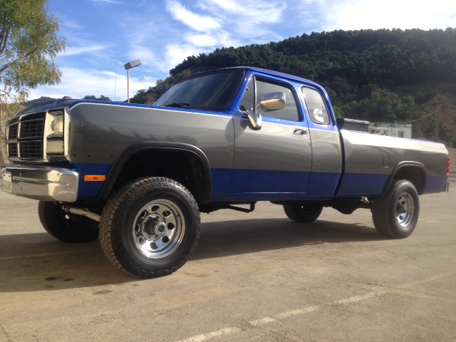

newbee here with 91 w250 cummins
I just bought this 91 w250 cummins 4x4 with a nv4500, going to be doing light engine work to it. was thinking of keeping it right around 300hp... thought/precautions!

Welcome aboard! Nice looking truck.

Welcome nice looking truck.
going to be doing light engine work to it,,, why what's wrong.
was thinking of keeping it right around 300hp,,,, OK
thought/precautions! ,,,,,,,,, I"D fix the steering and brakes and all the other warn out junk thats on these OLD trucks befor I think about more horsepower.

Really nice looking rig.

very nice rig, what was the trans problem, shifting?

Joshua sounds like didnt take my (thought/precautions! ,,,,,,,,, ) in offense.
Steering LK real good and hard at this.
The steering system is the weakest link on these trucks. In your pic I see you have those shock stable things on your truck. when I see those that tells me something is wrong.. I"d check the king pin bushings or the whole thing. there is a plate on the 4X4 trucks steering box that mounts it to the frame VERY famous for braking and frame cracks at the same point.
https://www.dieseltruckresource.com/...enance-302761/
https://www.dieseltruckresource.com/...g-pins-290373/
https://www.dieseltruckresource.com/...n-half-320841/
This I what I did to my truck to fix that issue. Lots of good info in that post but at the same time a bunch of weeds to pick though https://www.dieseltruckresource.com/...ng-box-299031/
LSD rear ends the clutch packs in them barely make It past 150k
I can go on & on But I wont.. like I said B4 truck looks nice keep it that way
