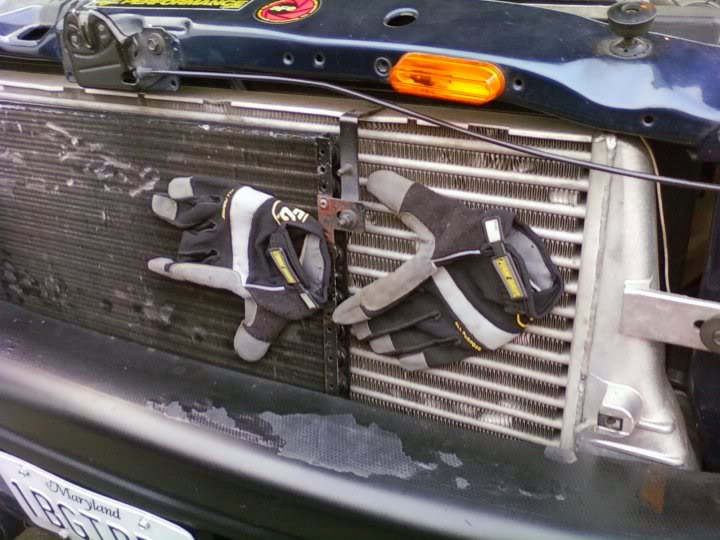

Hope this helps the electric crowd.
1 single Lincoln Mark VIII/Ford Taurus 3.8L V6. They have dual fan setups. Gloves were dropped above and 5-6" away from the coolers.
