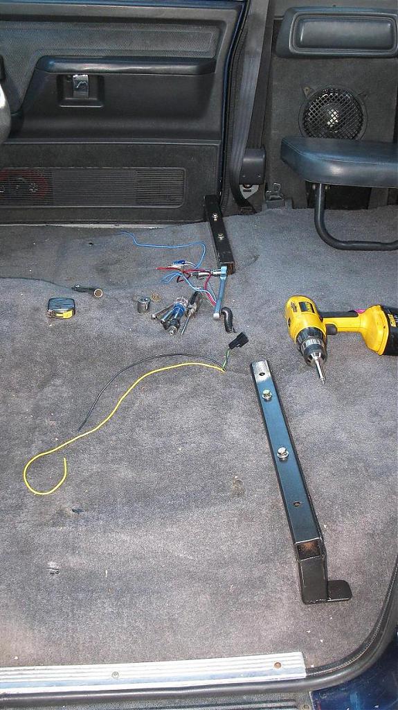

OK. So the install has been a little slow, but it's getting there. Unfortunatley there wasn't time for some pics but there wasn't much to look at anyways that hasn't been seen.
I ended up building some simple brackets to accound for the different mounting brackets and floor pans. Pretty simple really. and I'll get a pic or 2 before I bolt the seats on. I ended up drilling some new holes for each mount point but it came out pretty decent so far.

Sneak peak........
Here's a sneak peak at what I came up with to mount the 2nd gen seats to a 1st gen floor pan.
#1 forget the original holes.
#2 the new brackets are mounted just in front of the hump where the center seat belts mount to.
#3 1 of the new holes catches the original body rib for strength and another hits the reinforcement for the seat belts.
I'll post a pic when it's approved.....
Old Sep 24, 2009 | 04:30 PM
ofcmarc's Avatar
Posts: 1,797
Here's a pic.
