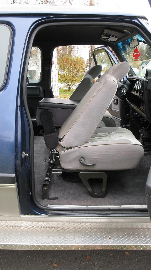

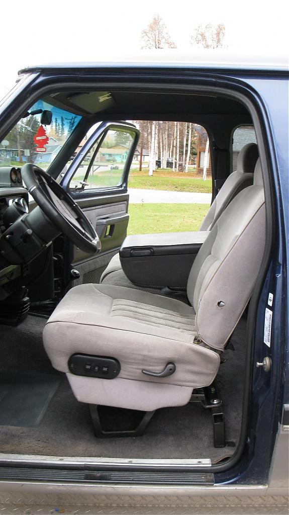

Well, I finally got the project done today. WOW! What a difference. The new seats defiantly sit higher but even at 6'2" they aren't too tall. I even have to slide the seat forward a bit to disengage thew clutch completely. Power seats even work well!
As promised here's a few pics.
Viewed from the driver's door.
Viewed from the passenger door. The seat actually slides a bit further forward than pictured and makes for easy access to the back seats. I can climb in fairly easily if needed....

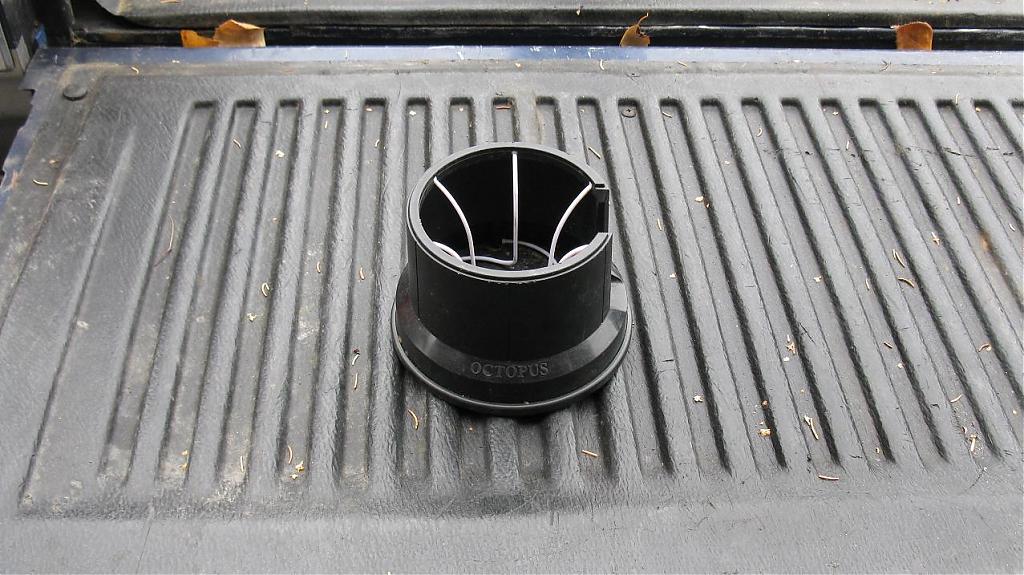

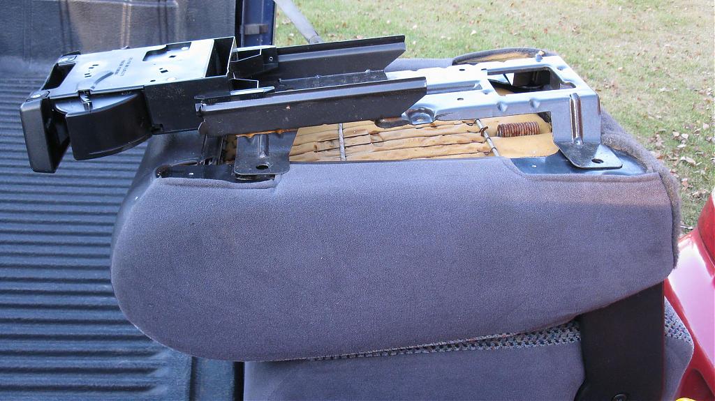

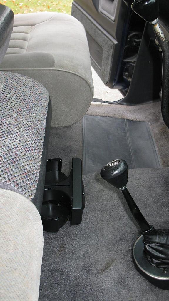

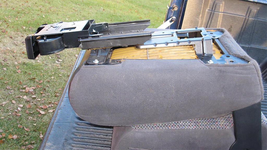

OK so after almost a month I still like the seats however there is one small problem........
Frost heaves in the road along with a foo foo coffee for the wife one day made a mess all over the freshly shampooed carpet....... Cause, the cup holder doesn't extend far enough to let the contents sit correctly.
The cup holder was originally designed for use by the rear passengers in the donor truck but I just rotated it 180* and had it come out front. It bolted on using the center section mount bolts. At a glance, it all looked good. In actual trials, not so much.
But wait! A solution......
The center section seat frame is all sheet metal and easily drilled. I simply removed the center, turned it over and used a few self tapping screws and moved the cup holder mount forward about 2.5 inches.
Much better...
Maybe I can keep the coffee off the floor now......
