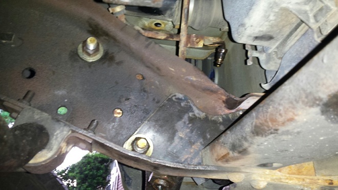

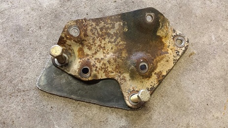

to the OP, if you can't find the brace that goes on the backside or don't want to foot the bill for one. here is what I did. just used some 3/8" plate cut to fit inside the frame rail behind the steering gear. my frame doesn't flex in that area anymore, even turning 33s.

x2 still have the original plate after welding frame and mounting brace.
