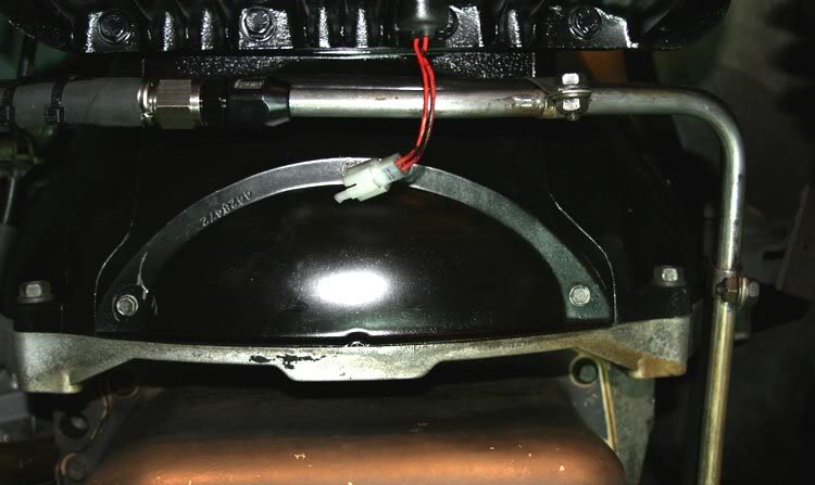

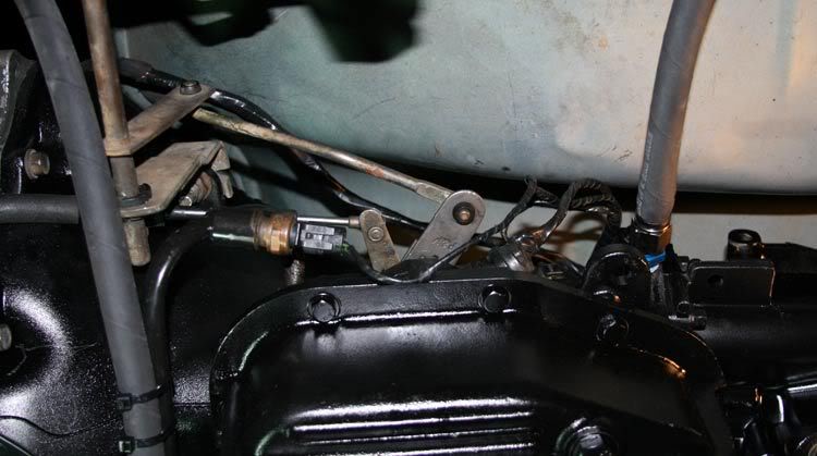

Climb under the truck, driver's side.
Looking at the driver's side of the transmission body, you'll see the shift linkage.
Just forward of the linkage, on the side of the trans body, you'll see a metal line that goes around and under the torque converter, and to the heat exchanger under the exhaust manifold. It's that line with the brass temperature sensor built in.
That steel tube is the hot trans fluid as it leaves the trans on it's way to be cooled.
That's where you need your sensor if you can't mount it in the pan.

BC847,
Thanks so much for posting your response and pics! You definitely clerified things for me and where they are located. I noticed in the last pic (showing metal outlet tube).......it appears to transition into a rubber line, is that true? If so, my fitting pictured above is designed for splicing into a rubber hose. Perhaps I can install it between the metal outlet tube and the block mounted cooler? Correct me if I'm wrong......

No, that rubber hose is where I converted from worn, leaking metal tubing. Sorry.
Perhaps you can exchange the hose barbs for flare or compression fittings to fit the steel tubing.
FWIW, in that first image, the hose at the right of the image, that's the fluid Return to the trans.
