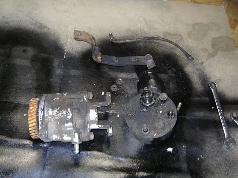

I'm missing bolts, how many? As you can see in the picture, I only have one holding the thing on. Is there supposed to be 4 bolts? I need to know this asap because I am supposed to be heading out on a road trip today!

In a word, yes, and it appears that the one is loose...Mark
Old Feb 21, 2011 | 02:39 PM
Technically the top two are studs with nuts, and the bottom two are bolts. Need to get something in there ASAP. Man one bolt holding that reservoir on, and no support from the lower bracket for the aluminum vacuum pump housing...your luck it didn't snap off!
Here a pic of what mine looked like when I go the parts to do my conversion....it actually has 4 studs and nuts.

No wonder your seal is leaking!
