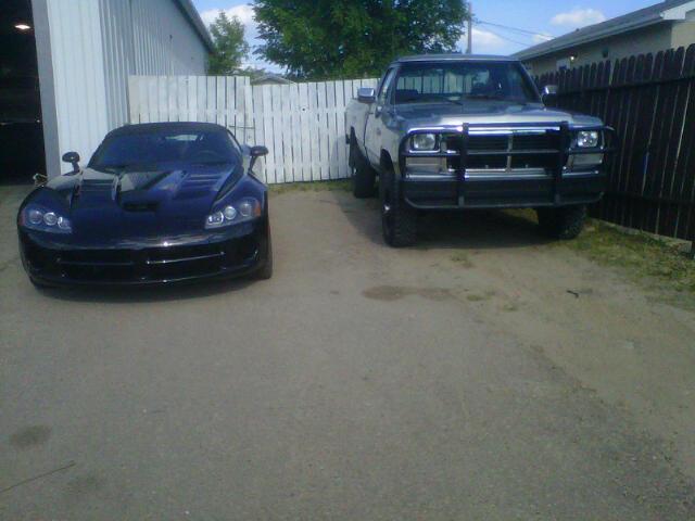

Its all fixed up except waiting on the new bumper. Old one is on for now.
