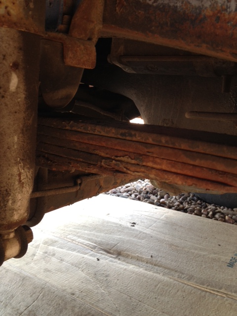

Ive put over a million miles on the suspension, hard working miles. The truck rides like a washboard and the front suspension feel like it bottoms out on every bump. Are the front springs supposed to have some positive arch to them. If they are, is it better to have these re-arched or just replace them? Input on upgrades and parts and do's & donts are appreciated..

They need to be replaced, your stop should not be that close to the spring.

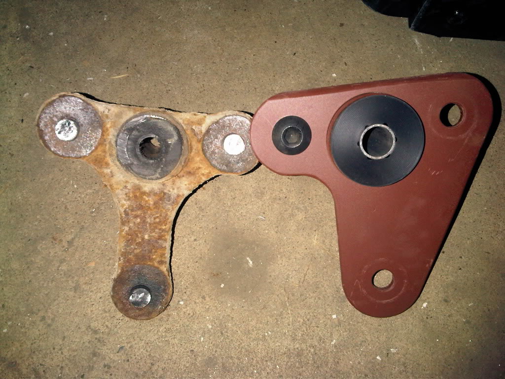

I installed jungles kit and its very easy, 2'' hole saw and drill away. A guide is provided so its not a big deal. Once the holes are drilled bolt it in and done.
The greasable deal helps smooth out the ride too.

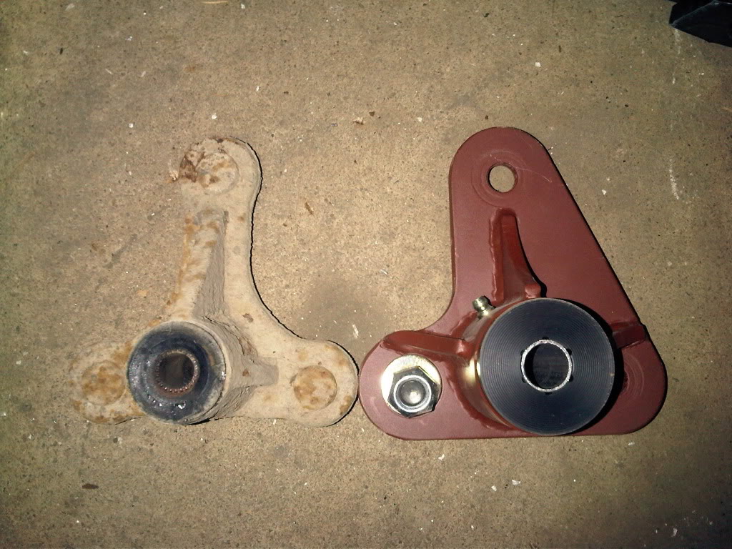

I didn't take many as it goes in pretty well.

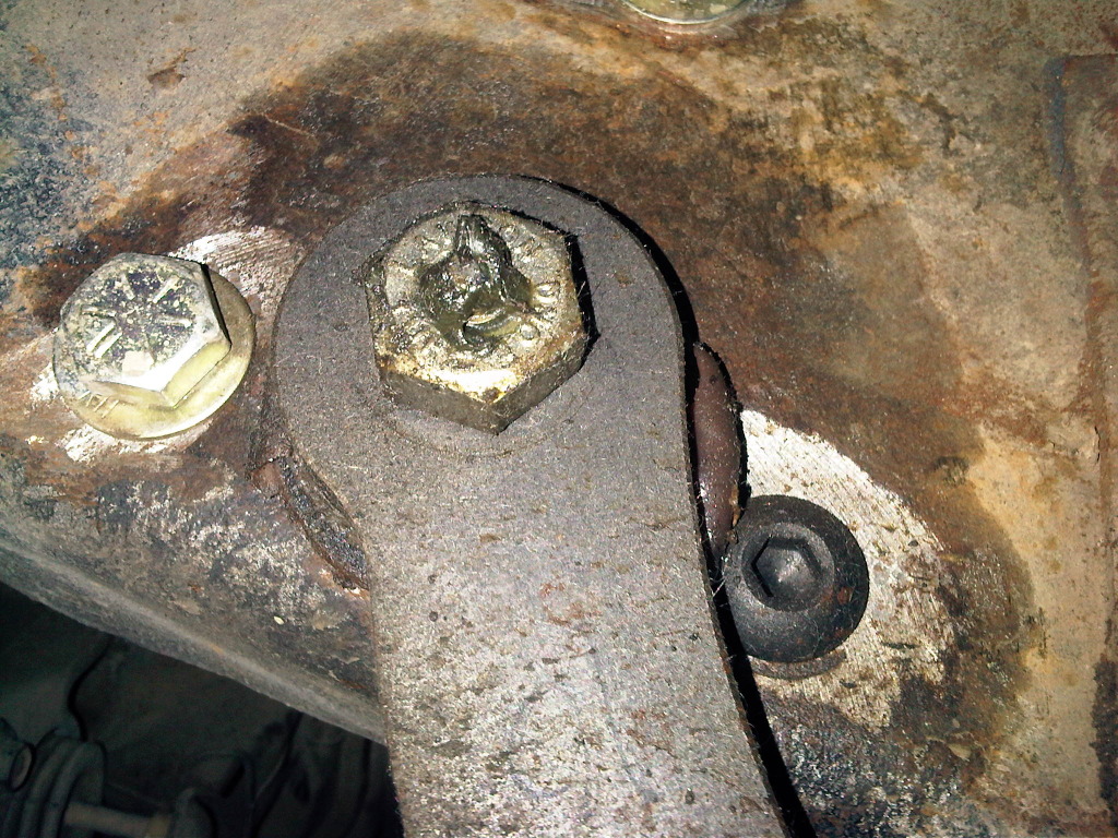

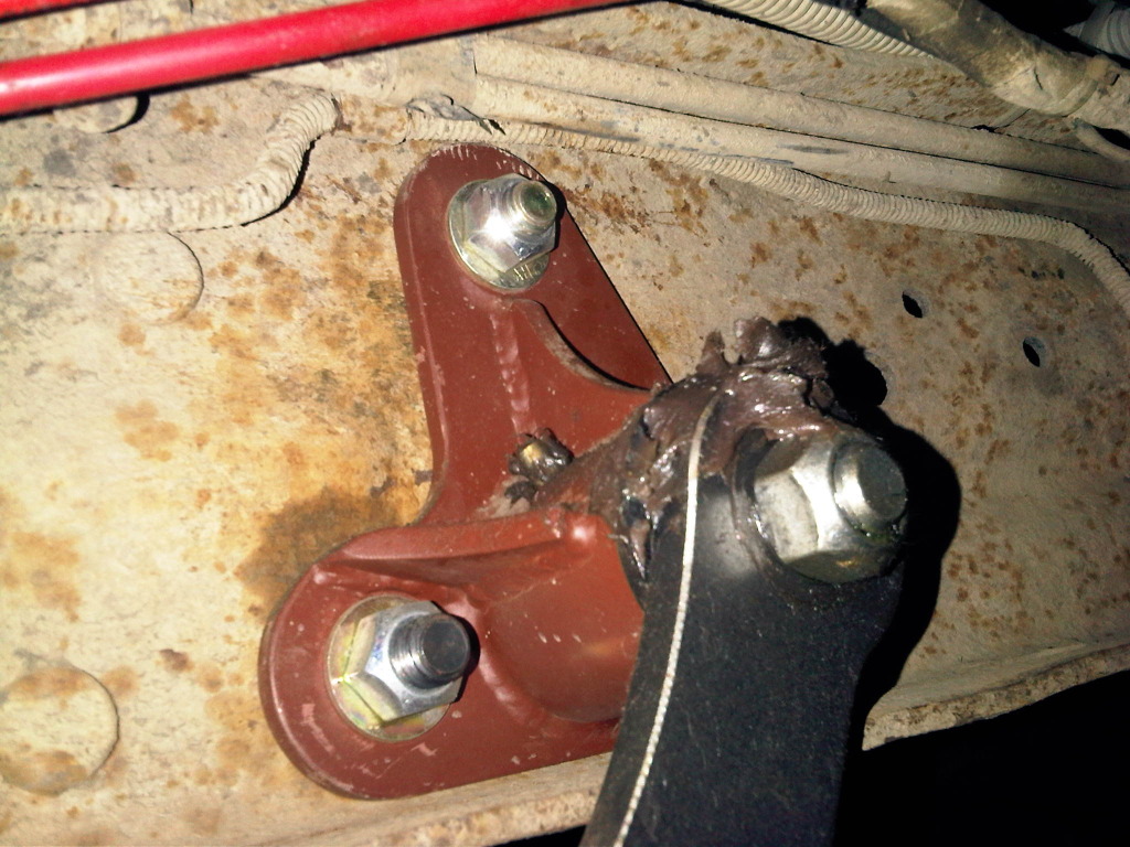

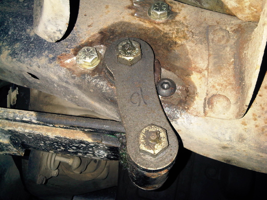

Not much to see i guess.

Is that the stock length shackle? It looks a little close I was thinking of getting his kit but with 1 to 2 in shackle

Stock length with 2'' lift spring. Springs haven't touched the frame yet.
