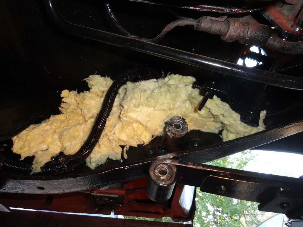

Well, I can say that this was an interesting learning experience. Don't do this unless you have lots of time and patience, as the first try at removal was difficult to say the least.
You need to get the truck lifted, with several pairs of jack stands, at minimum two (5 ton) units at the frame just behind the trans crossmember, and two (two ton) up front under the front axle itself. You'll also need at a minimum a floor jack to maneuver the axle up and down, but for comfort level, I used two separate floor jacks on the axle to have maximum control over positioning and for safety sake of knowing there was extra support @ the front should the need arise.
Once your truck is lifted up and the tires are removed, you can remove the rear shackle to access the frame bushing. Using a press won't work on these bushings, as they're shouldered on the outside and they can't be pressed through the frame. Each side has two bushings and they press in the tube towards each other with the flanges facing outwards They have to come out the same way they went in... and that's the difficult part.
For the first hour, I tried a few different techniques I read here, and elsewhere on the net. None of them worked for me, and in reality it made it more difficult in the end to do the job. Using a drill bit to remove the rubber around the sleeve sort of helped, but for the most part, all I did was break lots of drill bits. The broken bits in the rubber made it 10 times more difficult to work on the bushing. Don't use drill bits unless you're willing to curse a few times more than you really need to.
Being frustrated, with breaking all of my good drill bits, I decided to chisel away the outer flange of the bushing... Again, wrong move.
All that happened was I made a bigger mess that what I started with, and this is what I wound up with. A mangled mess that seemed almost hopeless to get out. I had to take a rest and rethink this process.
Eventually, after wasting all that time trying brute force to beat the bushing out of the frame, I loosened it up enough to finally get the center ferrule out. Once cleaned out, I could then chisel the outer shell out of the frame which left me with the other side to contend with. With this experience I will tell you that this was NOT the right way of doing this job. You can't beat them out without wasting lots of time doing so. Lying on your back for 3 hours really gets old after a while
I tried removing the inner bushing by tapping it towards the transmission from the outer side of the frame. I wouldn't budge. Thinking of a new strategy, I remember reading that someone burned out the rubber which relieved the pressure of the bushing, and the sleeve just came out. So I did just that. I burned out the bushing from the inside of the frame.

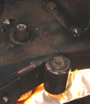

Keeping a fire extinguisher and bottle of water, and a bunch of wet terry cloth towels nearby, I took my mini torch (used in plumbing repairs) and burned out the rubber part of the bushing. To my amazement, the center ferrule popped out on it's own !
Make sure you have your glasses on and are ready for flying metal, as I wasn't expecting this to happen. After it cooled, I knocked out the outer shell of the inner bushing, from the outside of the frame with a few taps of a standard punch. Piece of cake with the other side removed, and the rubber bushing gone. Here's what was left of the shell and ferrule and the other side ferrule, I beat to get out
Now you have a nice clean receptor for your new bushings. I filed the distorted opening out a little bit to ease the installation of the new bushing. When you beat the daylights out of a bushing the receptor gets mangled a little bit. I filed the inside down to minimize resistance of the new bushing going in.

This was the passenger side.
The drivers side has yet to be done.
I'll be tackling that today. and with the knowledge I gained from doing the passenger side, I'm hoping to cut 1/2 the time
I'll expect a full report.
Supposed to be nice after lunch. 60s and sunny.
I've got a little bubble of rust starting on a cab corner...that's my project today. Just got an order of POR15 in yesterday.
Nice writeup, btw!

The driver's side took 2 hours less than the passenger side.... as with anything else, knowledge is power, and since the passenger side was my first time.... I was missing some power to do the work.
The bushings pop the ferrule right out when heated. as seen in this pic of the drivers side.. this one didn't hit me in the forehead, as it held on for dear life.
Once the outer bushing was out I could easily knock out the inner bushing with little or no hubub. The difficult part was removing the outer sleeve, as there are fuel lines just above, and I didn't feel comfortable with the torch near them as I didn't have a real accurate flame, such as a garage torch would have been. I used rotten cotton (known as firesafeing in the construction trades) which limited the amount of heat on the plastic lines, but I wasn't taking any chances otherwise. Plastic and heat don't go well together.
So I beat the outer sleeve out, and then knocked out the inner. once cleaned and reamed out, I reassembled the new bushings with the carriage bolt / socket trick. Worked out really good, as I didn't have to hit the bushings back in. Reality is, there isn't enough room on the drivers side anyway to do so, as the trans lines are blocking any access.
