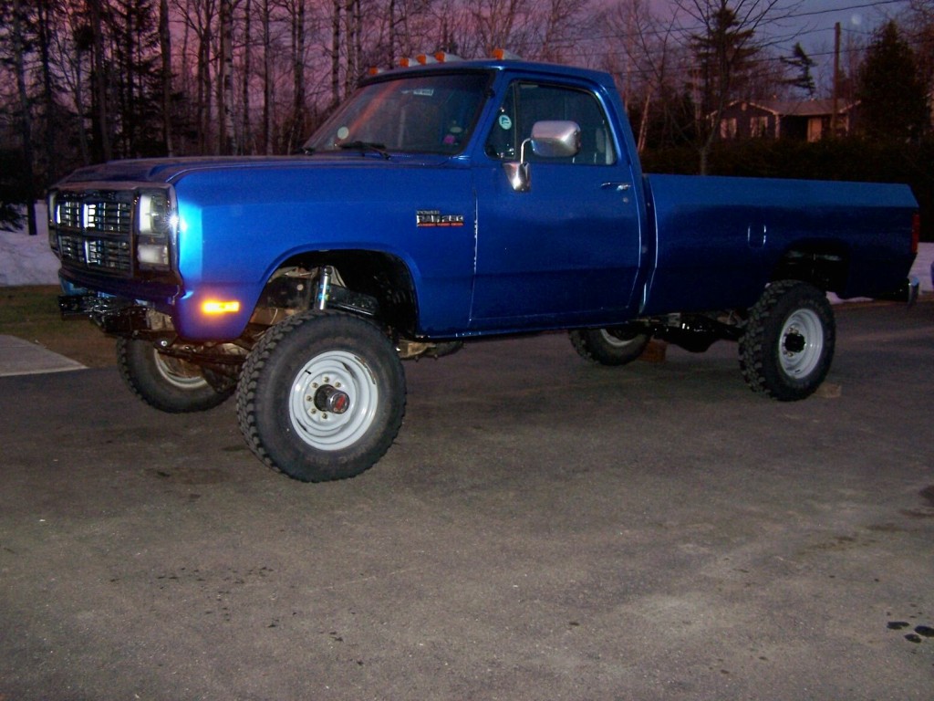

I ordered new front springs for my truck from Custom Suspension and they arrived today so I tore into it and completed the install. This is how the truck stance was before I removed the old junk........
As you can see my front end was pretty much sagged out. The bottom of my oil pan was level with the top of the front axle.

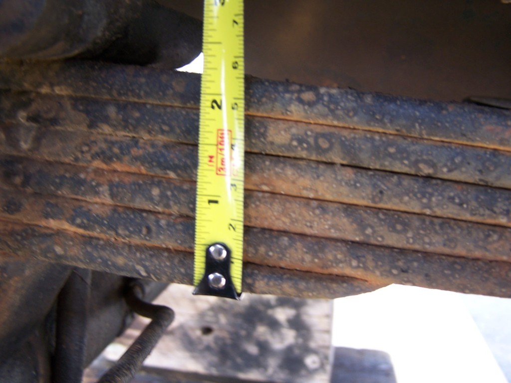

The old spring pack was 2 1/4 inches thick........ 6 ply

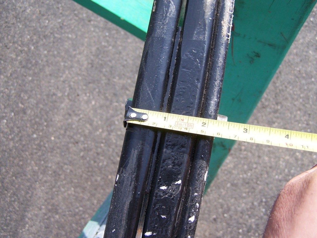

The new parabolic spring is also 2 1/4 inches thick.......3 ply

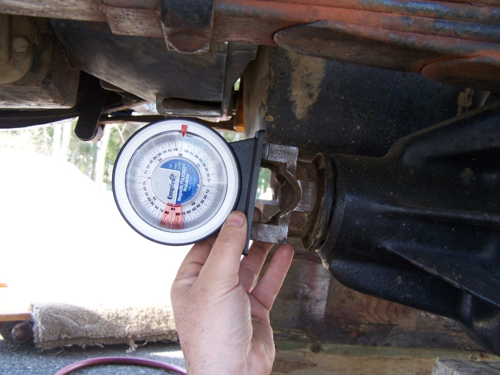

I checked the yoke angle with a protractor before and after the install and there was no change......

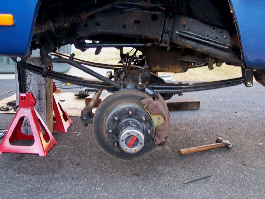

Final installation with the axle hanging.......
