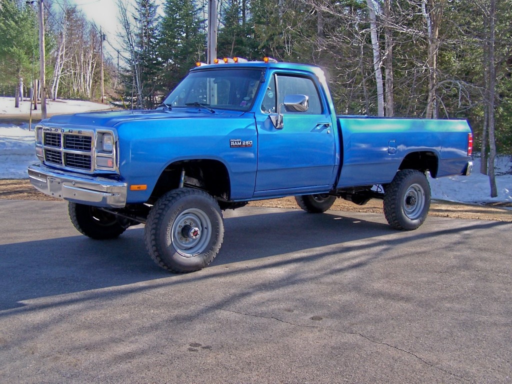

I ordered new front springs for my truck from Custom Suspension and they arrived today so I tore into it and completed the install. This is how the truck stance was before I removed the old junk........

And the final result at sundown........
The installation went very well and bolted up nice. The oil pan now sits 3 1/2 inches above the axle so my total gain was 3 1/2. They are a soft ride spring so my ride will improve drastically. I was told that the lift would be 2 inches above stock so I guess my stock springs were bagged out 1 1/2 inches. I complimented the install with a new pair of bilstien shocks. After 20 years I finally have my truck sitting on the level........

Here's a picture taken in the light today to give you a better idea of the stance. The spring pack on the drivers side is weak and the next ply down from the main on the opposite side has been replaced so it doesn't quite sit on the level in the back but money and time will solve the inevitable.
