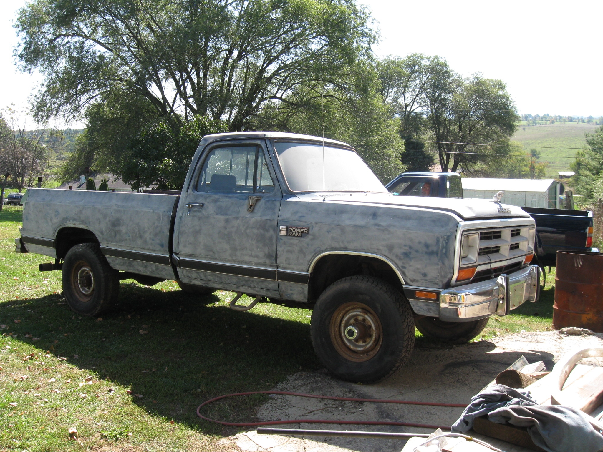

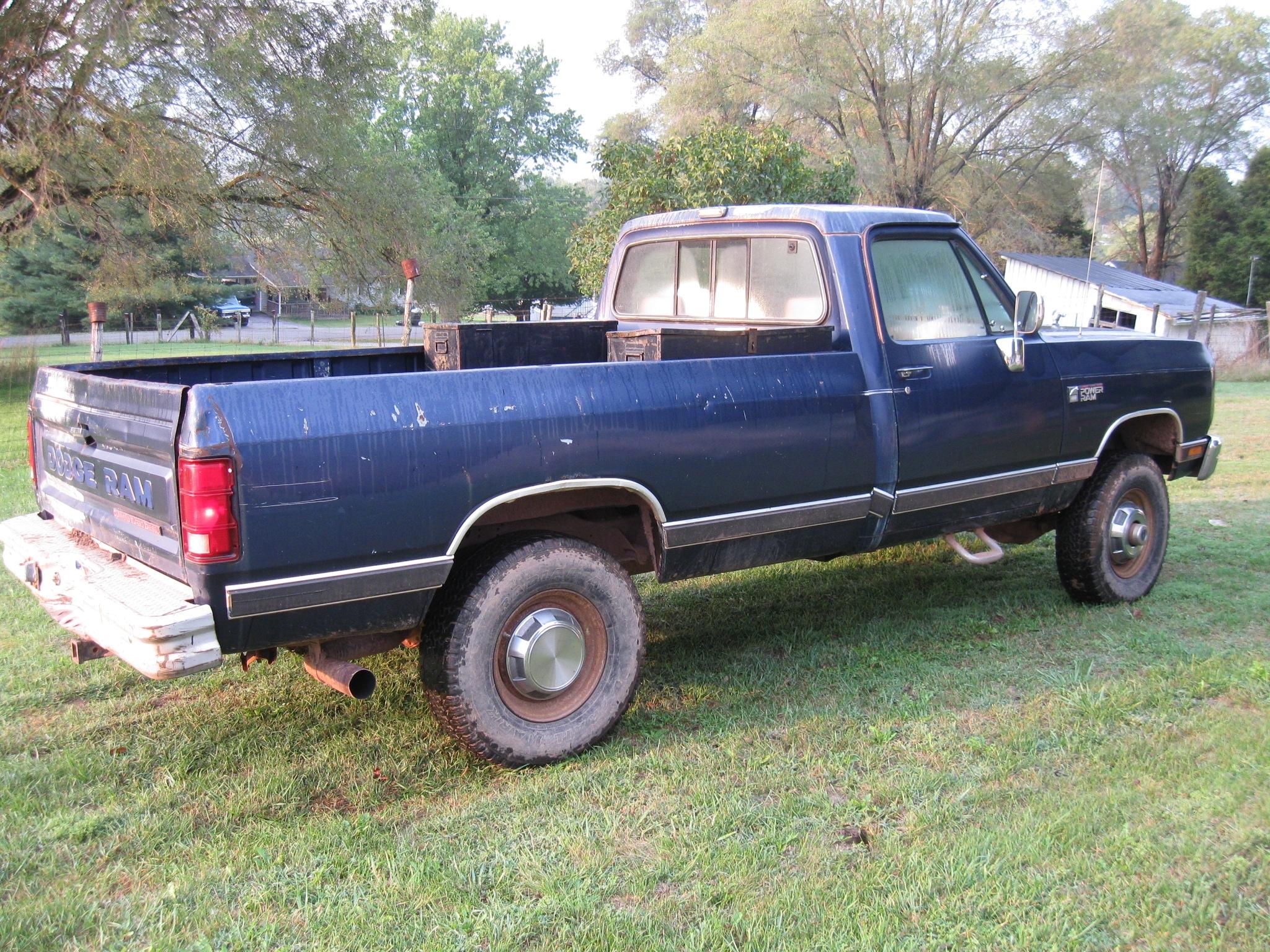

I own a 01 4x4 2500 HO 6spd, but I've always liked the 1st Gens too. Lately, I've noticed that they seem to sell for more than I remember. So, we decided to take on this 90 to restore and sell....

Mechanically, this truck is in pretty good shape, the best I can tell. It's got the adapting bell housing and a NV4500 trans.
Neither one of us have any mechanical ability on diesels, so I'm sure I'll have questions for ya along the way.

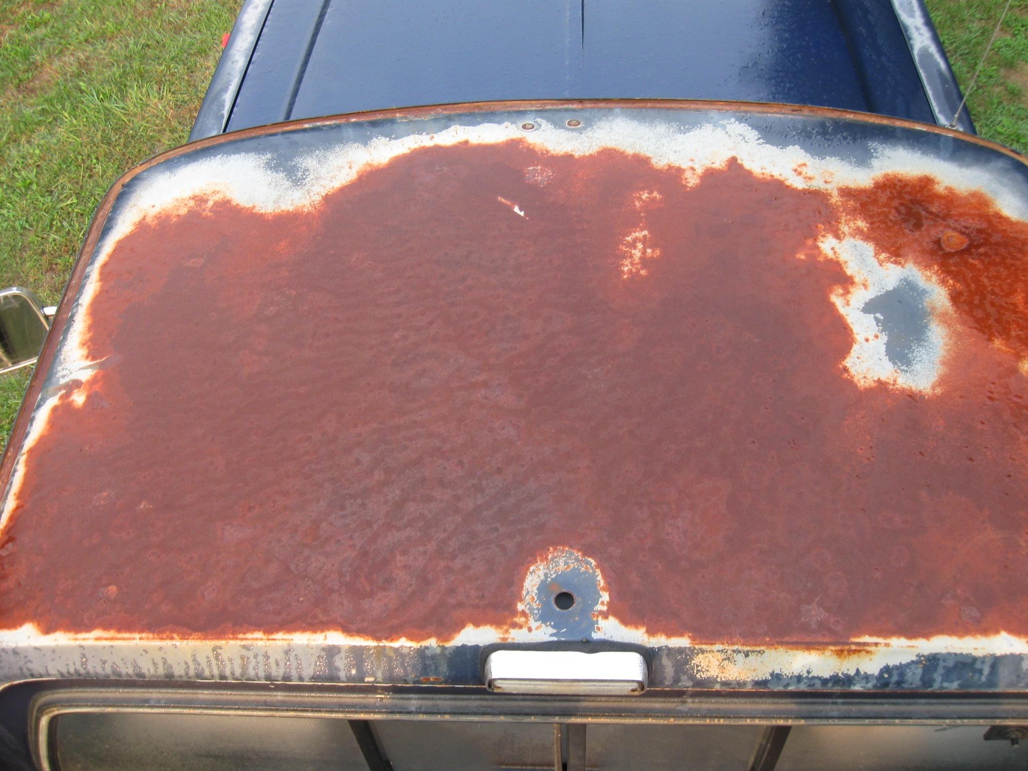

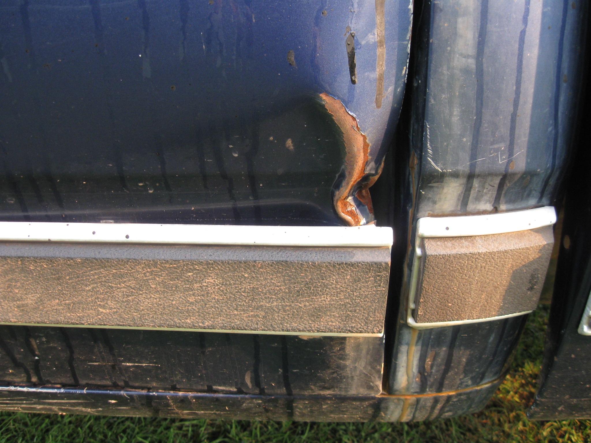

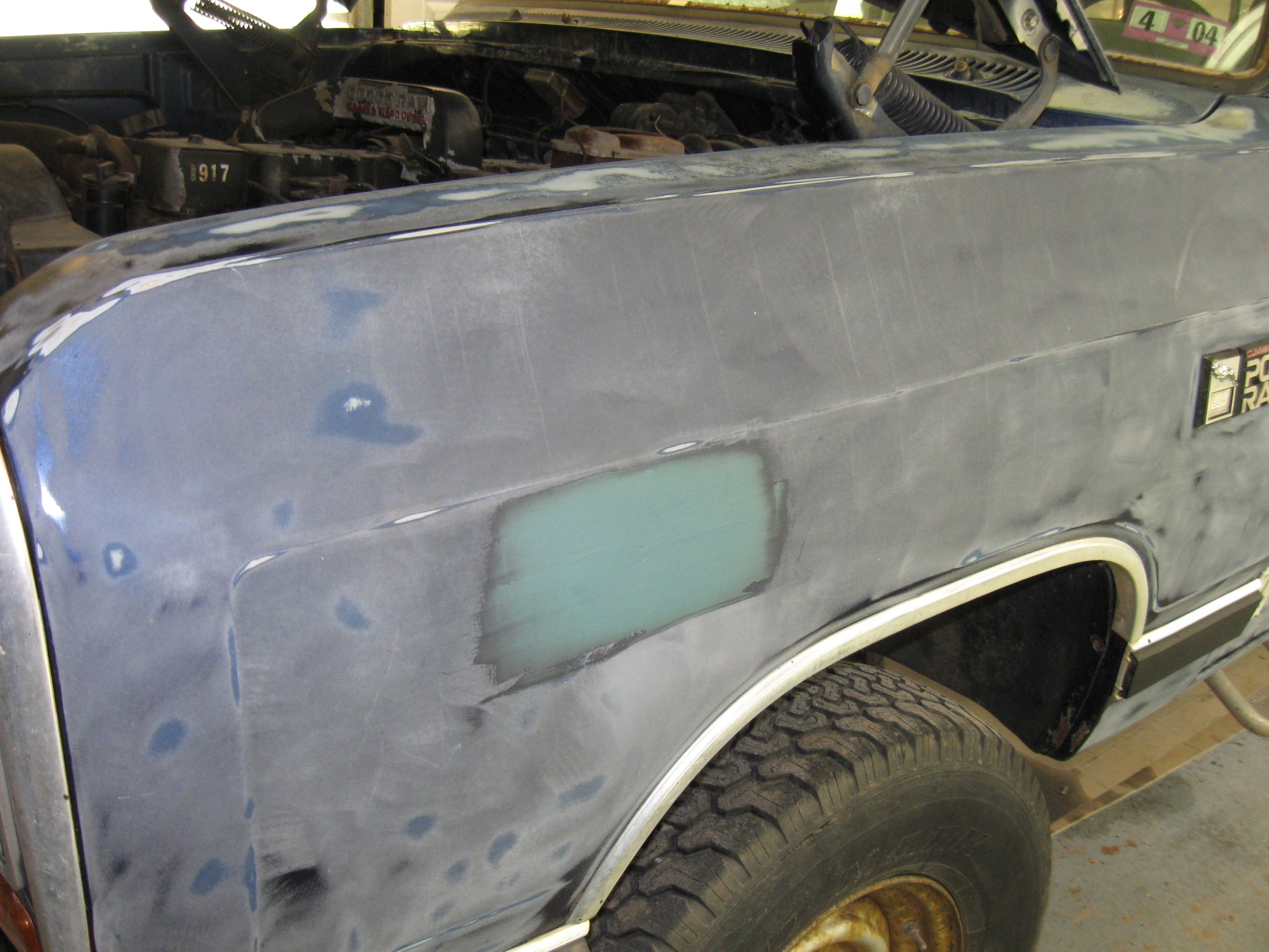

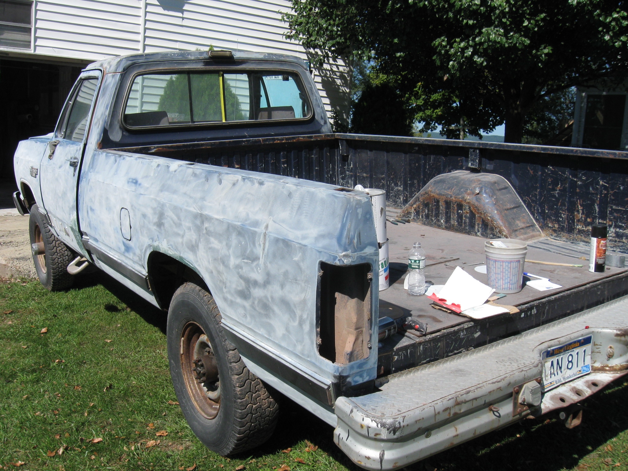

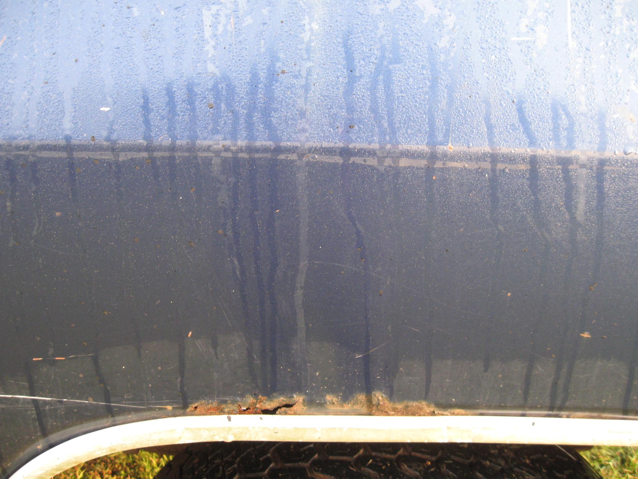

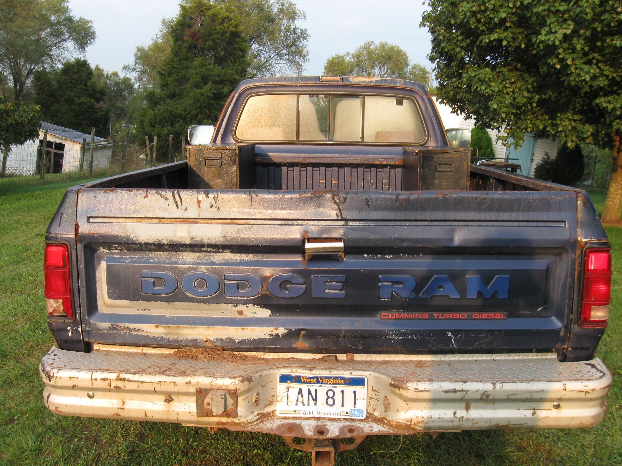

This truck has some body work kinda issues that will be fixed first....

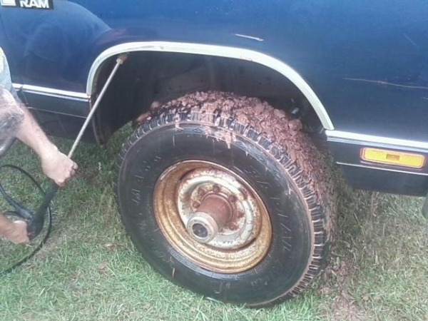

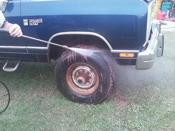

first was pressure cleaning.
When we bought this truck it was on a big farm in West Virginia.
I think we brought a big chunk of that farm home with us....

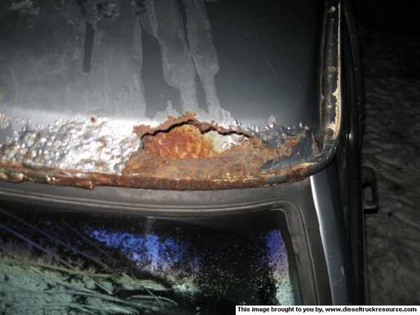

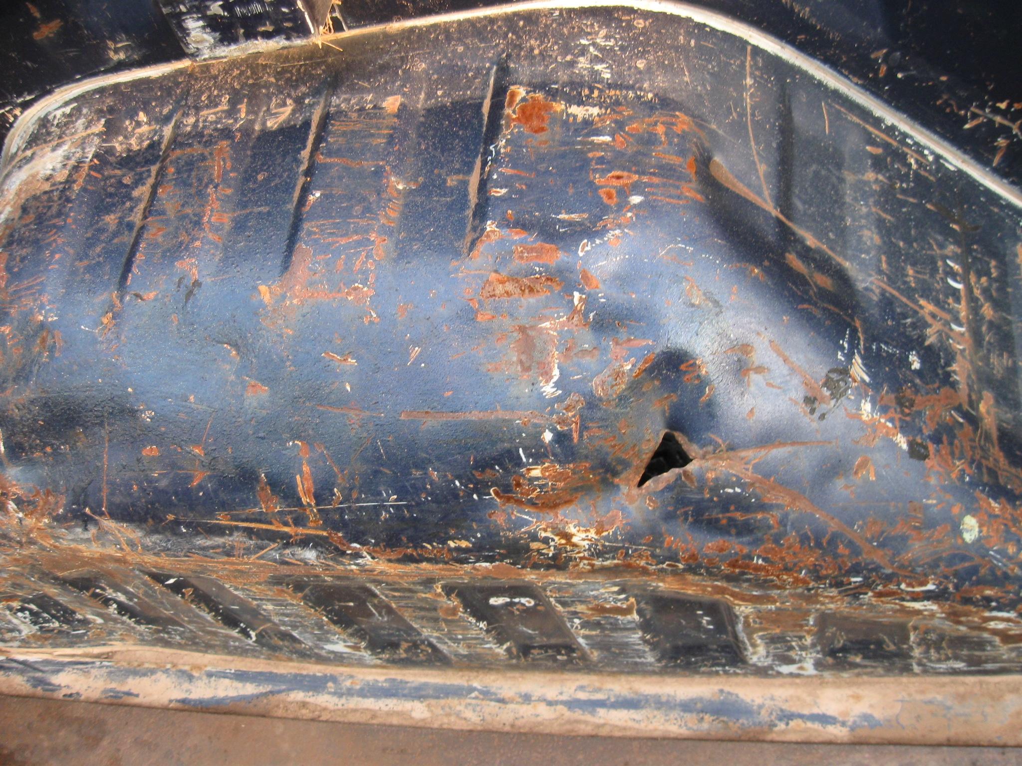

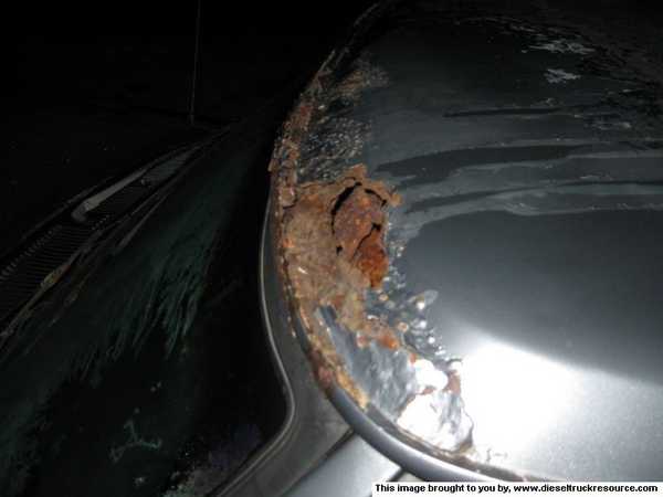

Talking about the roof, be sure to look hard, just above the windshield, just above the rain gutter for blisters in the paint suggesting there's rust burning through from the inside. Unfortunately, it's a regular thing with the 1st gens. When constructed, the roof (proper) is sandwiched with similar sheet-metal to reinforce it at the front. As such, the factory couldn't access between the metal sheets for priming/painting/rust-proofing.
In the 1st gen world, it's referred to as Cancer.
Thanks. Actually we just found that exact thing last Wednesday. I thought that was a really strange place for rust-through. You've just explained it. We didn't see it until we started sanding on the roof.
Thanks

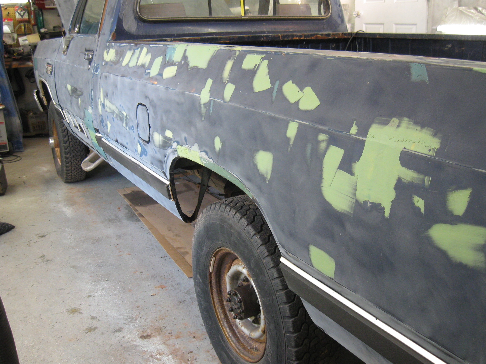

Starting on block sanding to find the low/high spots....

Lots more low spots to fill

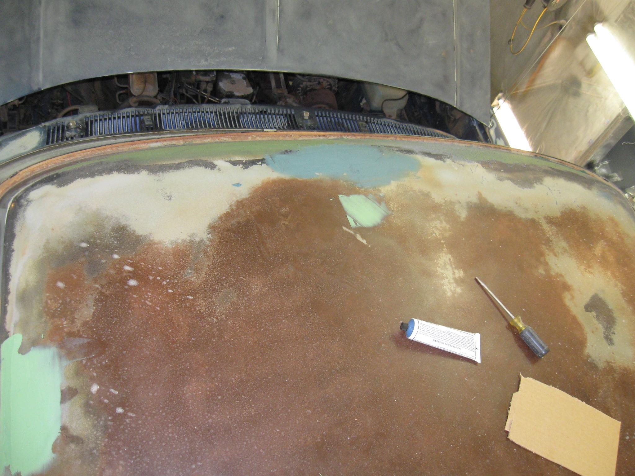

The roof rot wasn't anywhere near as bad as the one BC847 posted, but it did have problems. Grind, weld, Duraglass, then Chromalite....
