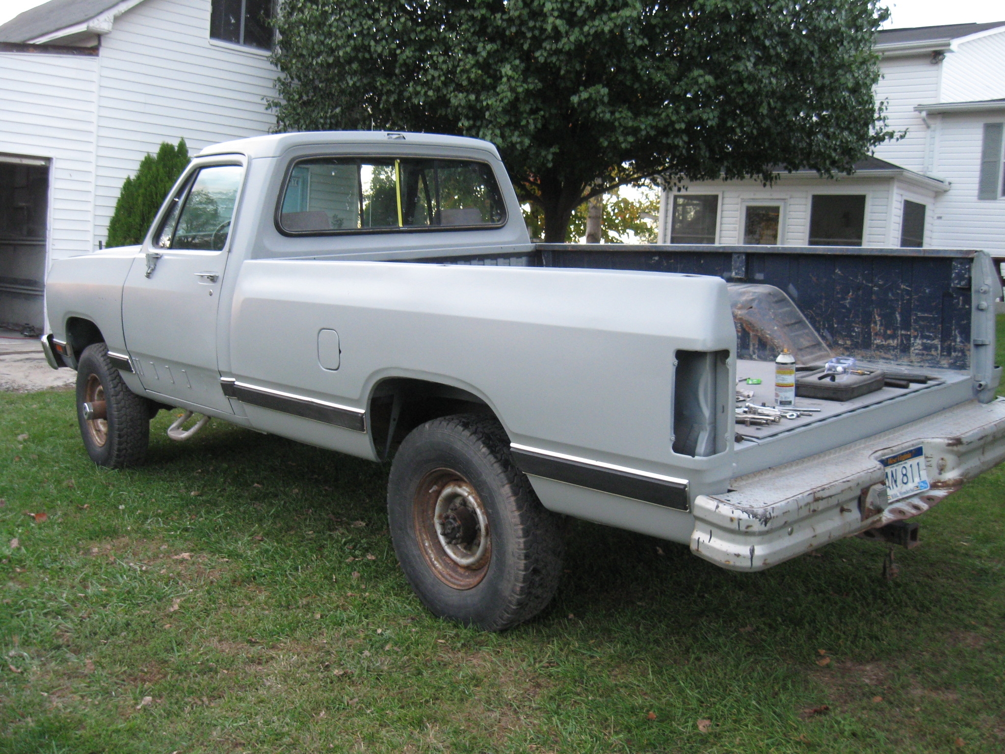

The roof all repaired and ready to go....

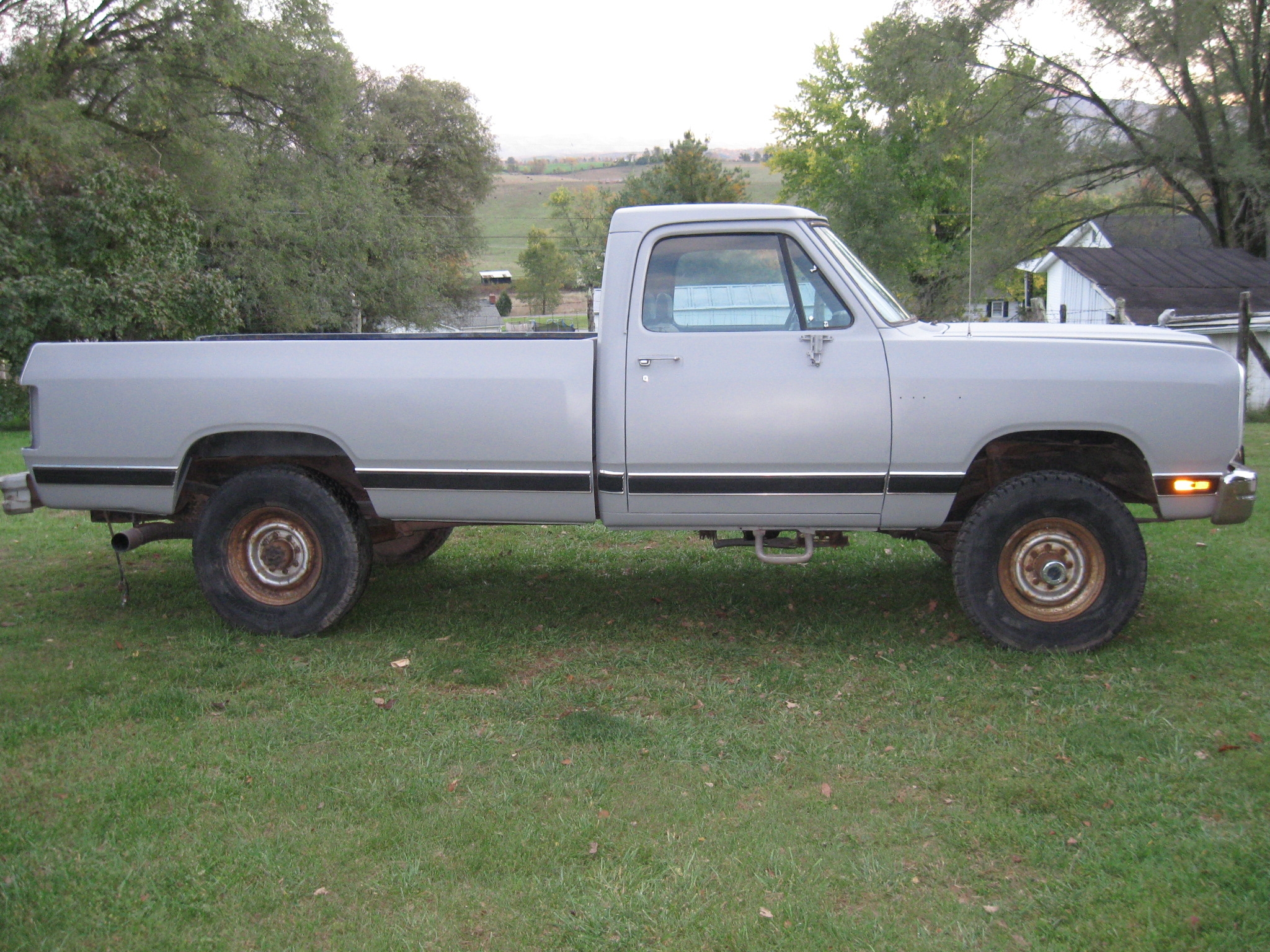

Got the high-build primer on today. 5 coats on the cab and 9 on the bed.

Outside, paper off....
