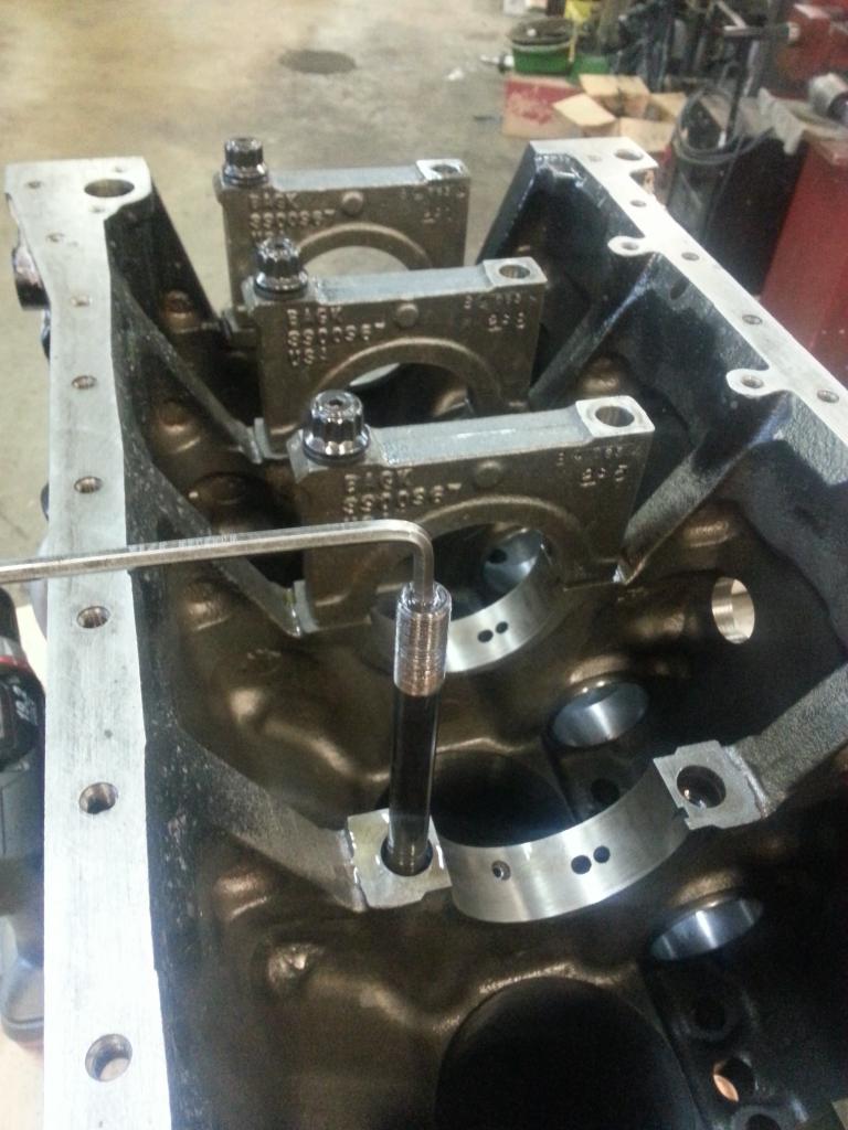

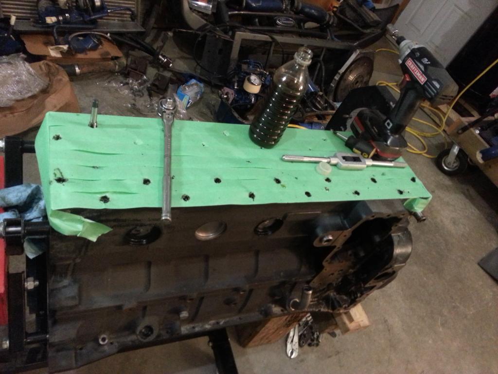

In any case, last friday I drilled and tapped the mains for 14mm studs. It went well. I only snapped one picture of that because I was rather dirty and my phone ended up dying anyways.
Then last night after getting the crank home I began putting it all back together. The block is a storm block, which is great.
What I had done to the block:
Cut for cam bushings (also had em pressed in)
bored 0.040" over
Decked 0.010"
drilled/tapped for 14mm mains (I did this)
align honed
crank polished

Last order of business after that was bottom tapping the head stud holes. I run A1 head studs. I use the oil as lube, the drill to spin it down and then the socket and 3/8 drive ratchet to actually do the bottom tapping. Normally I would use the tap handle like I did when I did the mains but these holes are already tapped and I'm just cleaning em up and taking a little material out at the bottom so it's not a big deal.
bored 0.040" over
Decked 0.010"
align honed
crank polished
