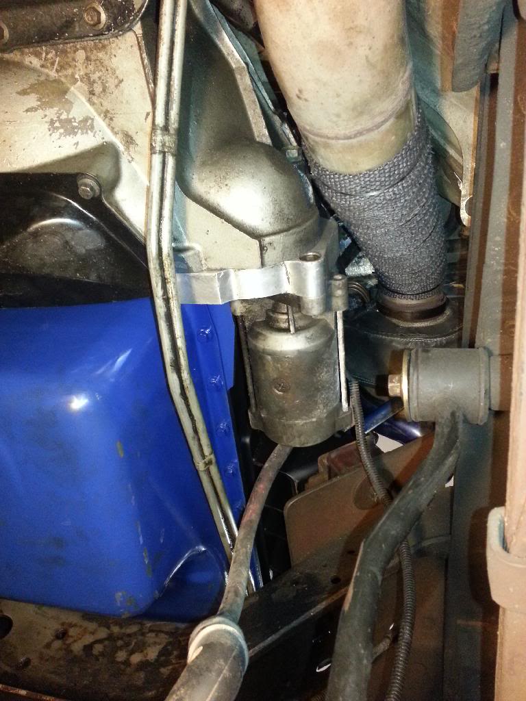

Starter, check

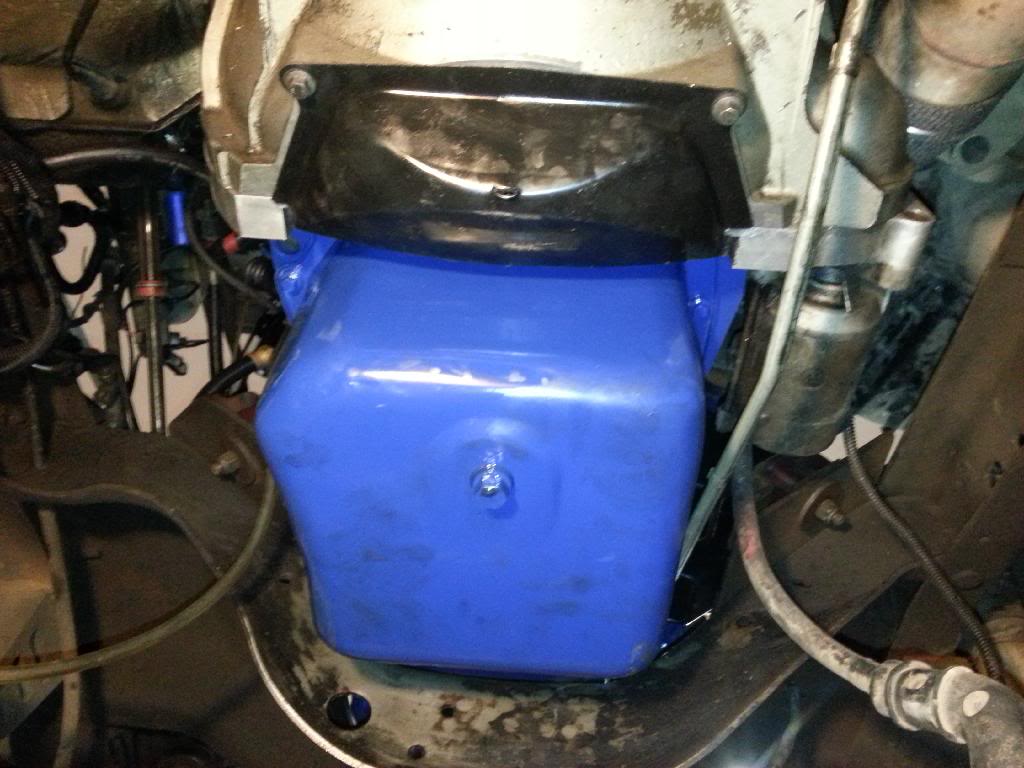

converter buttoned up, check (not that you can see it anymore...)

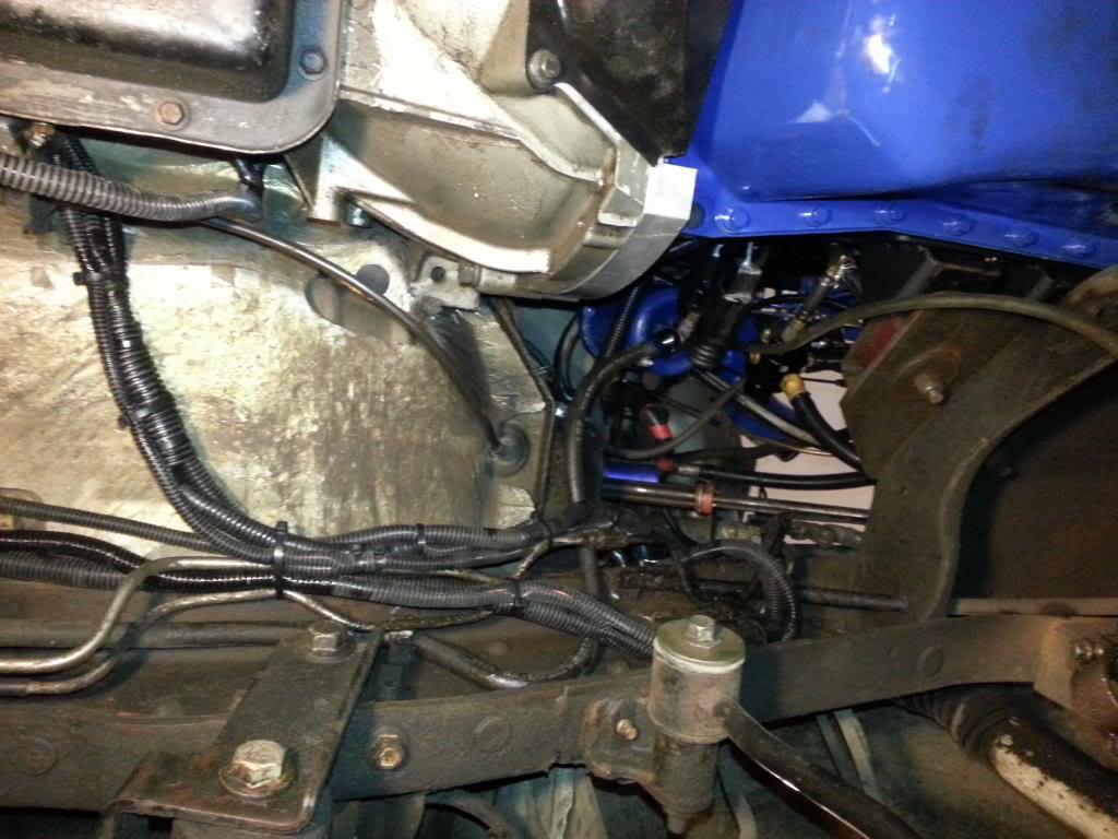

Driver side wiring I cleaned up the other day when I finished off the pusher pump. Lift pump is up there too, I attached the line for that tonight

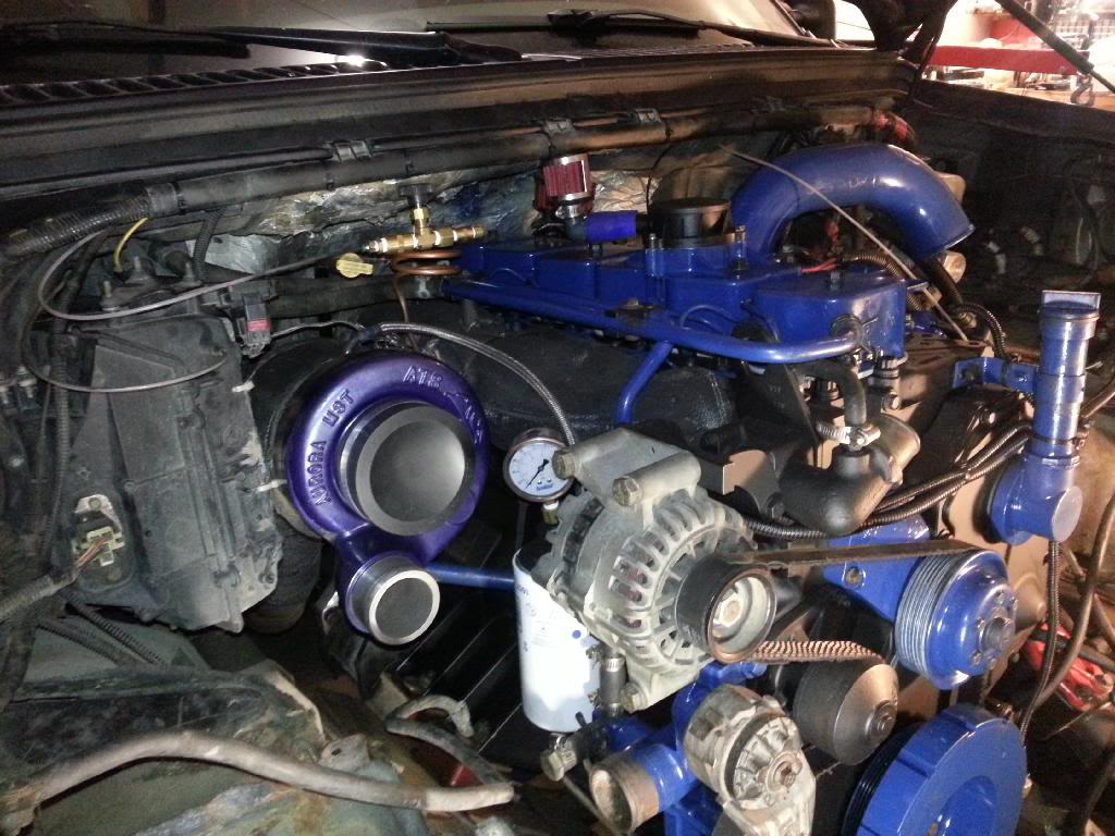

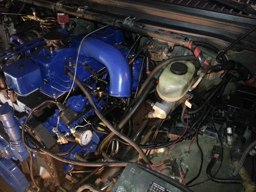

Passenger side of the motor

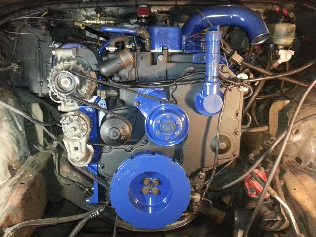

Front view

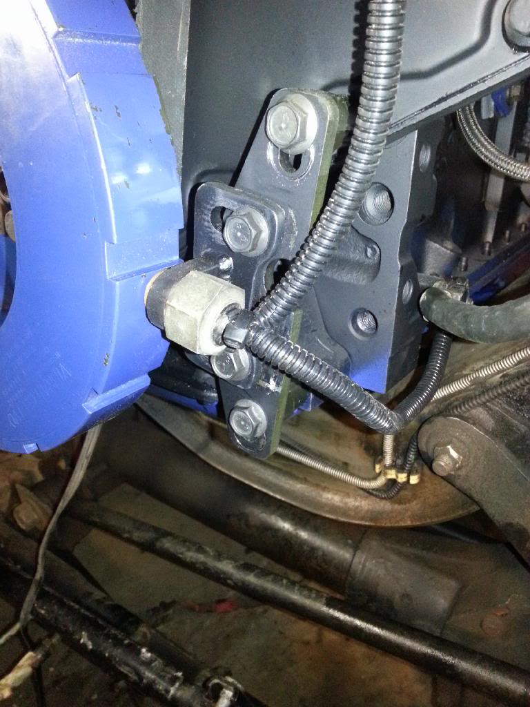

New tach location with the modified brackets. Looks good, except for the lack of paint
Front view

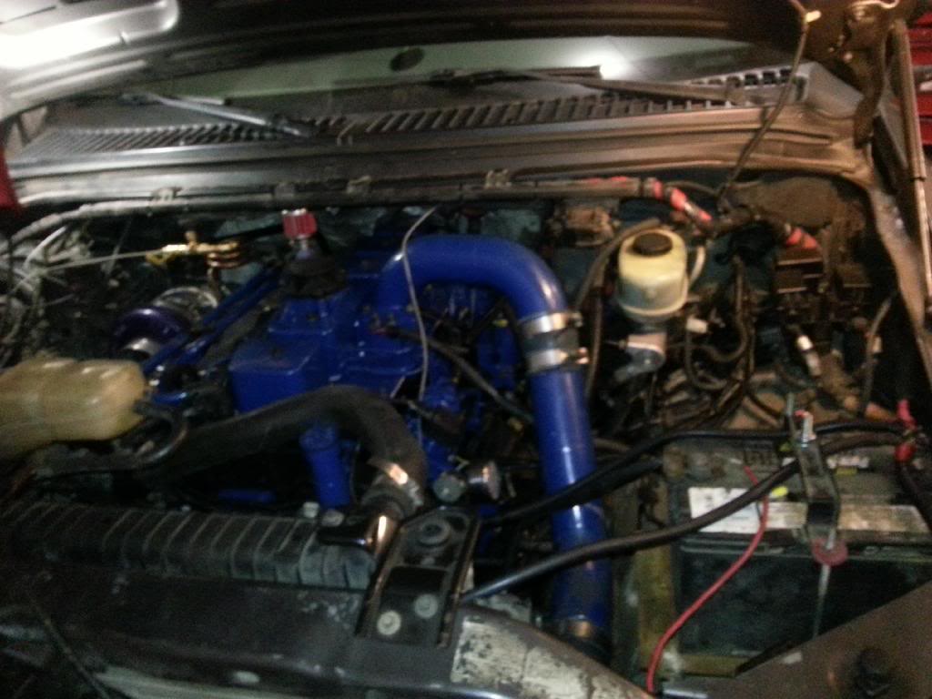

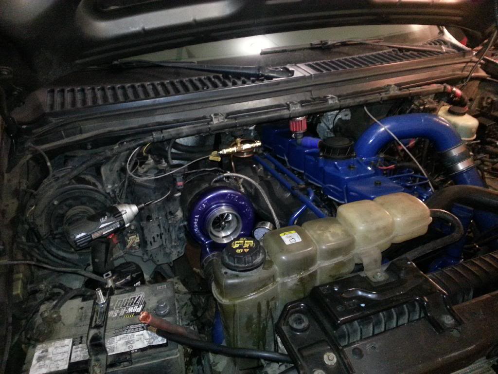

Welp, tonight I almost got it running. I finished off the wiring and got the front end together, save the grille, bumper and headlights. I have to replace one of the headlight pigtails. Had to order one from Napa. Should be in tomorrow. Coolant is even in it now.
Has power but not to the starter yet. The TPS is working exactly like it should. So is the pusher pump and valet. I left my volt meter some place that I don't remember so once I find that I'll verify power to the FSS and KSB and if that checks out I'll be good to go, except the power to the starter issue but that's a simple fix
It seems I did manage to drip a little coolant as I was putting it in
managed to make it blurry
Front view
Front view

The valve cover thingy is a valve cover crank case breather.
And the line I think you're referring to is my fuel pressure line. The big white gauge coming off the side of the ip is my case pressure gauge.
