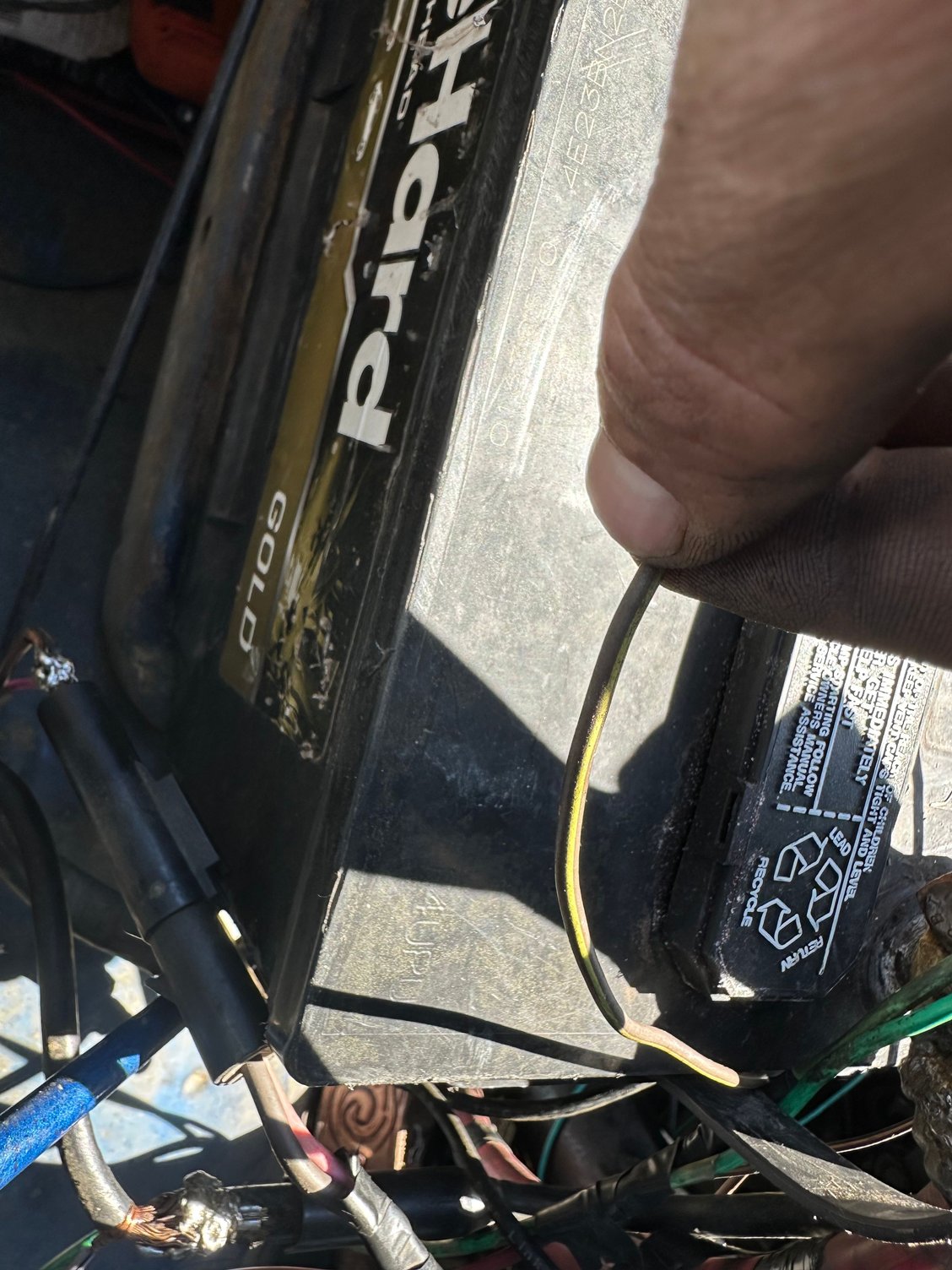

I had my nss bypassed by hooking the brown with green wire to the negative battery terminal was working fine until yesterday now it won’t crank any ideas?

I just install a small loop of wire into both plug ends for the nss that you will find under the dash, by the clutch pedal.
I have never had to run a wire all the way to the battery.
