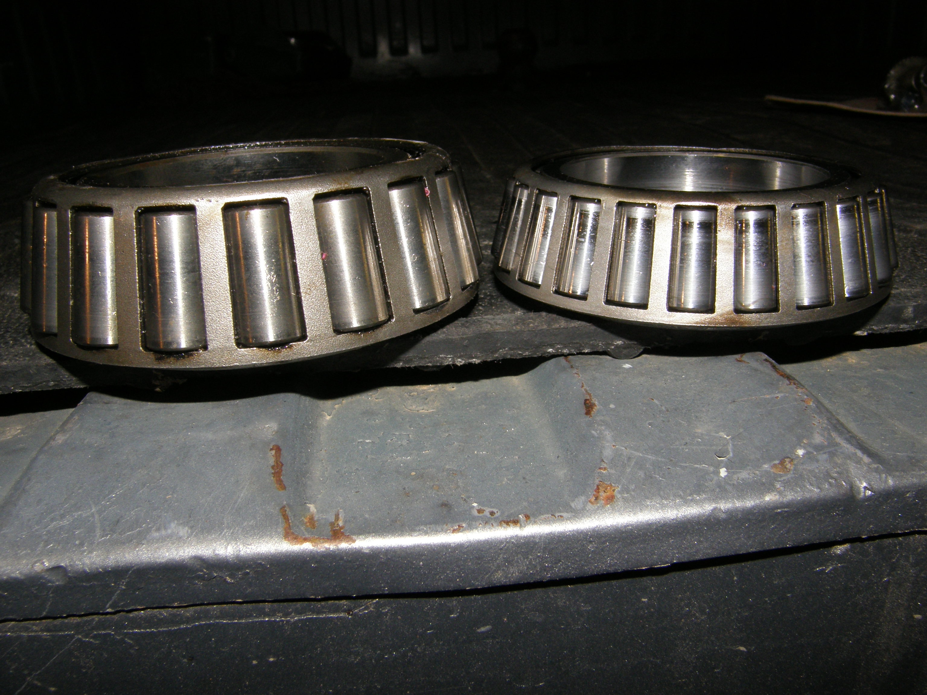

Dually rears also have much larger inner wheel bearings.

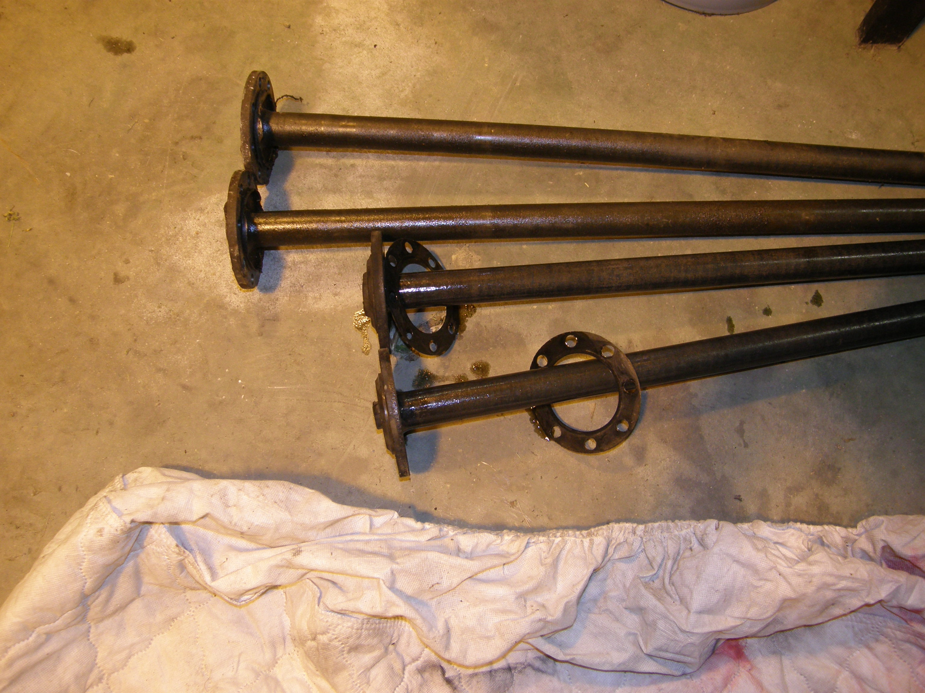

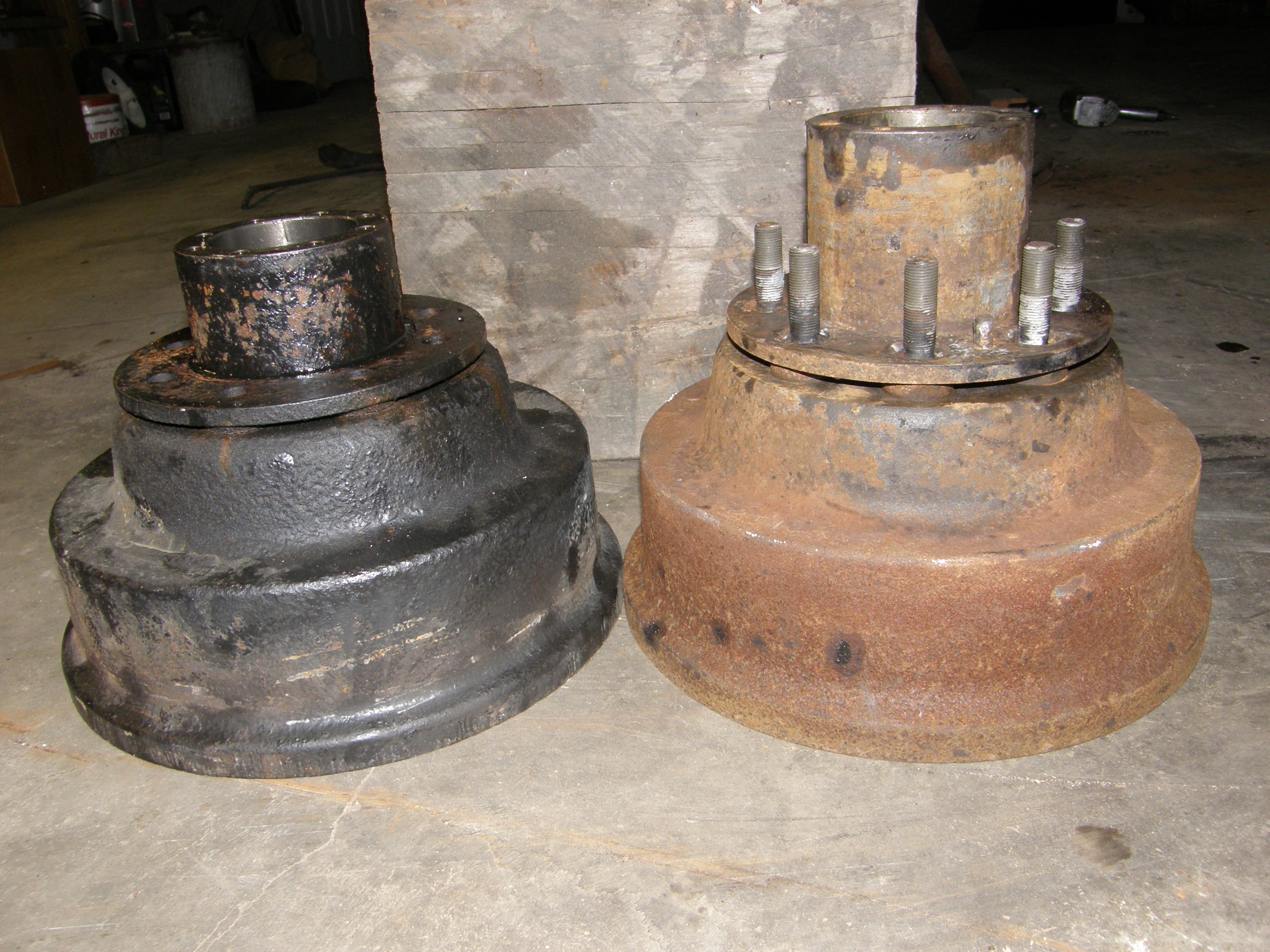

Here is just a few obvious differences, the rear end is a full 7 inches wider.
the spring placment is the same on both rearends.
Darwin

the lug nuts will be 5/8th on the dually and 1/2 in on the SRW D70

a dually rearend is 60 inches from the inside of the break backing plate to the other, like Faith said you can go with an arrowcraft spacers, but it's not a good idea to be hauling alot of weight on that setup, it can and has been done but i believe it's a problem wating to happen.
the weight raiting is almost 1,000 lbs more than a D70 SRW.
you need the spacers so the inside dual will clear the springs.
i believe the person that told you you had a 1 ton rearend was misinformed or was just going by the fact that they were both D70's, as i also was preaching that my rear was the same as a 1 ton, untill i got one and dismantled them both side by side and saw all the diffefences.
Darwin
