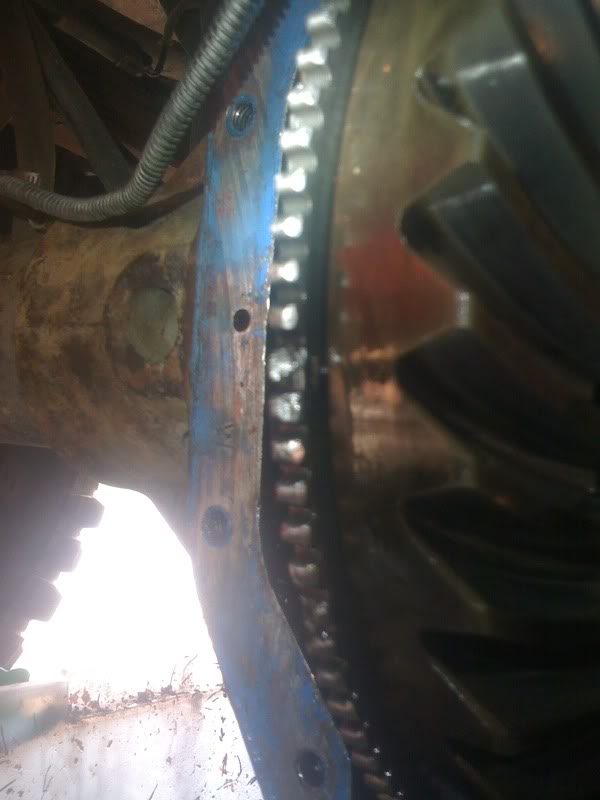

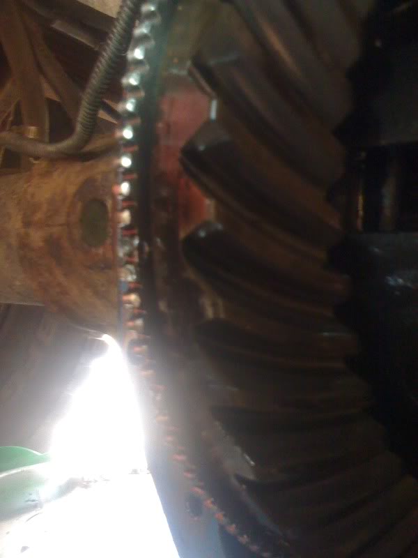

so for the purpose of removing a stuck ABS sensor, i opened up my rear diff cover. noticed that there were two teeth somewhat chewed up.

is this something i should deal with asap or what are some thoughts?

Old Aug 4, 2010 | 02:36 PM
SOOT4BRAINS's Avatar
Pod Boy (on hiatus)
Posts: 484
From: Mesa,AZ
Thats the ABS tone ring and having it chewed up like that usually means something is out of whack enough to let it rub some thing. Since your sensor broke it may have rubbed that and chewed it up. When my axle broke it was because my carrier bearings were so bad it allowed it to chew against the case. If your fluid looks ok and bearings feel ok then having the teeth chewed on there won't hurt you. To check the carrier bearings just try to wiggle the carrier up and down with no load on the axle. Pop a pry bar in there and gently see if it moves up and down.
Old Aug 7, 2010 | 09:23 PM
grim's Avatar
Joined: Jul 2010
Posts: 240
From: victoria bc
i dont think it was the sensor that tore the teeth up cause we broke that upon removal. so it must be something else. It is only two teeth that are chewed. i didnt try the pry bar but everything in there seems solid. Still visible play inside though when spinning the tires.
