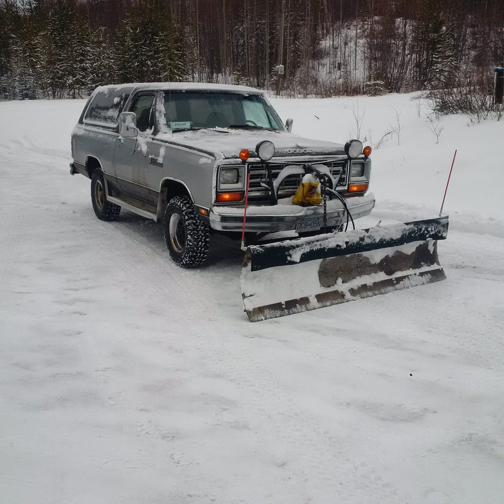

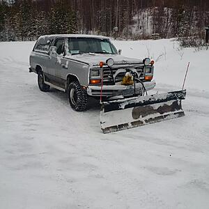

My 85 Ramcharger is a factory optioned Sno-Commander....so it came from the factory wired and set up for a Meyer E47 plow system. I has been a plow truck it's entire life and still works great.
