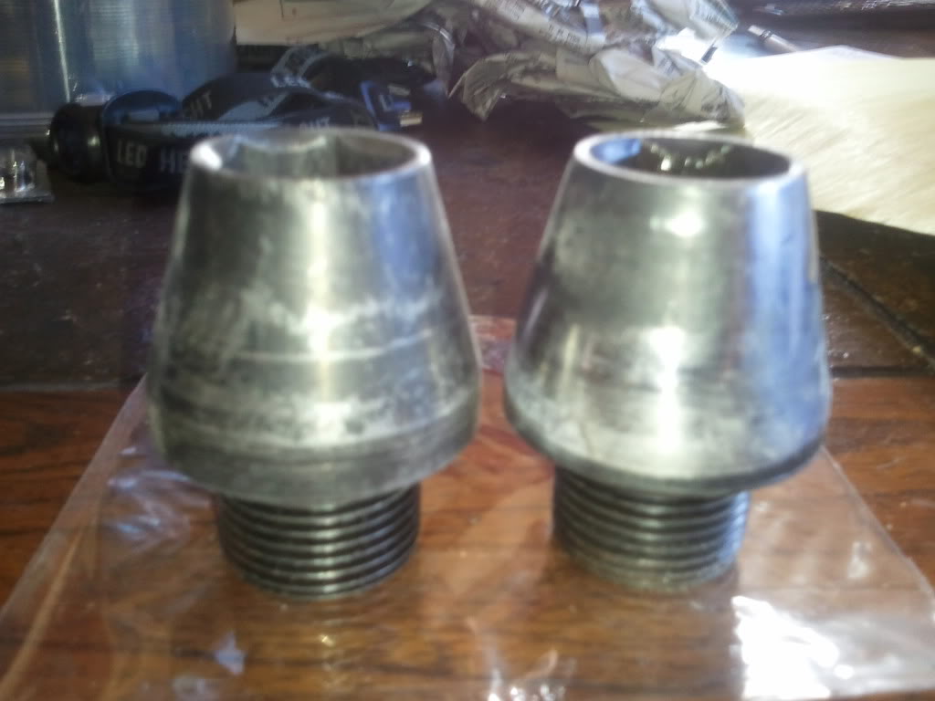

My driver's side kingpin (right) compared to the new one on the left.

Old Apr 16, 2011 | 09:00 PM
MoparMarv's Avatar
Posts: 783
From: Oak Lawn, IL
I finally ended up heating the one side up on mine glowing red before it came out would the impact. The other side I just did the plastic bushing because I ran out of time and needed the truck.

It took an 8' cheater to pop the kingpins, but they came loose no problem. I tightened them the same way.
