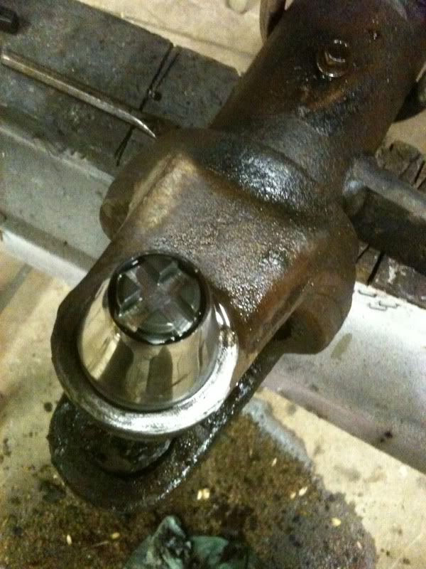

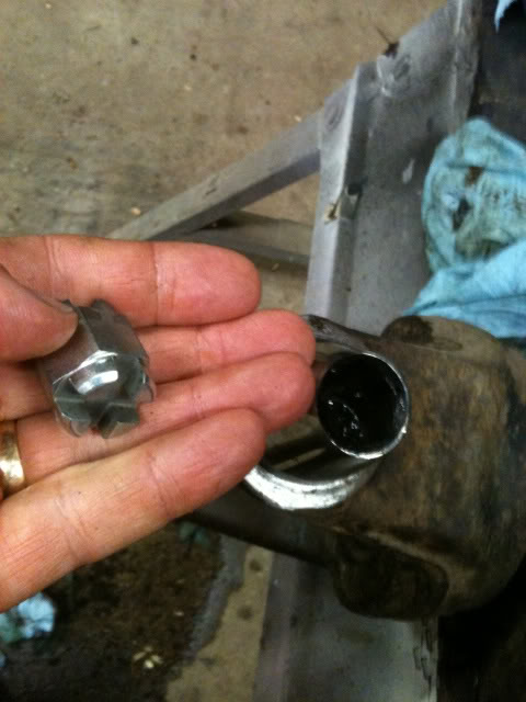

First, when I cleaned on the black grease that was once red off the upper pin I found something that I had not seen on the three or so other kingpin front ends I have had apart.
Is this part of a removal tool? I have not seen this thing before.

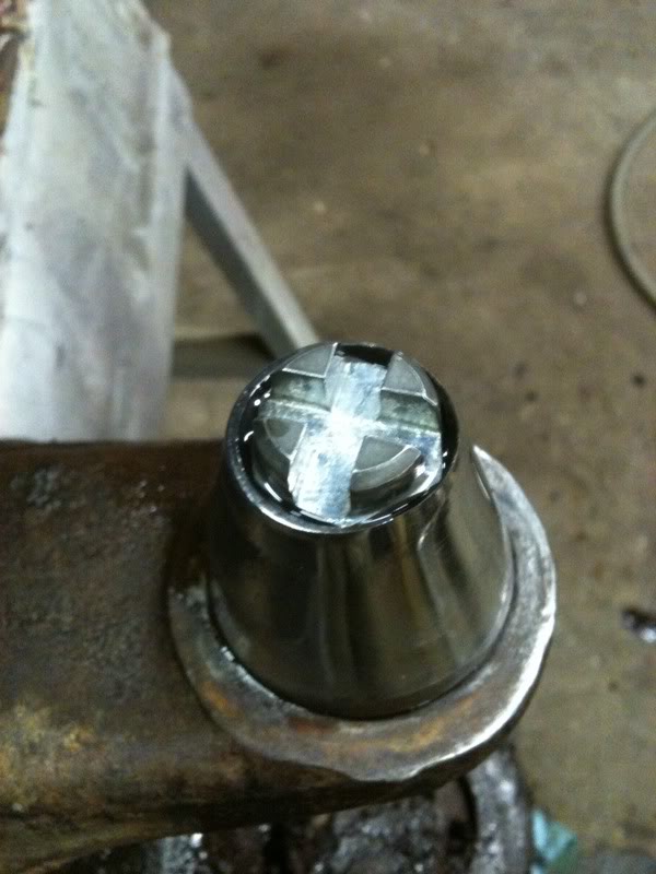

Second, The drivers side upper pin is seriously worn on the outboard side. Notice in the pic the sharp edge on one top of the pin. Compared to the inboard edge, there is a lot of meat worn away. The top outer edge is knife sharp.
Does anybody have a source for the upper pins. I have found the bearing/race kits and the upper bushing kit, but I definitely want to replace this pin.

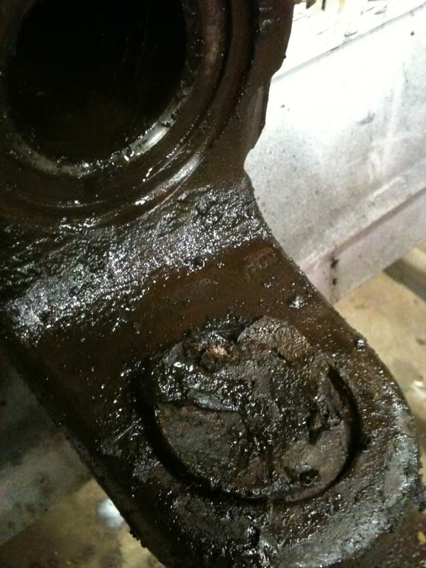

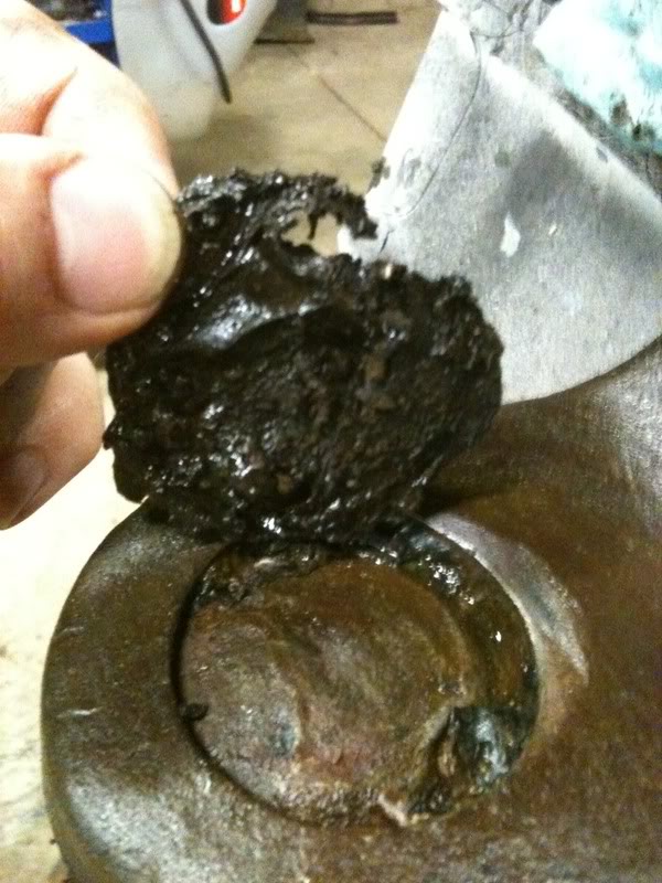

Third, look at this mess of sealant that somebody crammed in here to avoid replacing a dust cap that they had punched holes in.

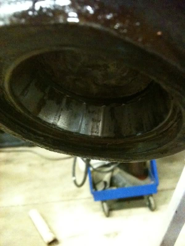

The great gobs of goo did not work. The bearings were toast and take a look at the condition of the race. It looks like maybe somebody did a lot of straight line driving on dry bearings. It is the only thing I can think of that would cause this wear.

Wow that is a lot of wear on very hard parts!

That insert is part of a camber repair kit, probably due to the work kingpin. I also used 4WD Factory for my parts.

What kind of condition were the rest of the upper parts (bushing,eccentric,cross pin) ? that's not a cheap kit and might be worth a few bucks to someone that might need it, or if you do just in case you don't end up within spec after your rebuild. SPC Proformance makes them if you do end up needing to reuse it.
Old Jan 26, 2011 | 11:48 PM
Trooperthorn's Avatar
Posts: 890
From: Salem, OR
OK, I see what you are talking about Bogie. I found this picture. There were not any other parts beside the nut looking thing. The eccentric, pin, and other parts in the pic are nowhere to be seen. There was just a large white plastic bushing, spring, and a couple of nylon washers.
