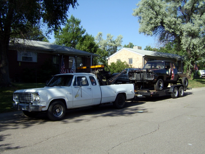

Thank you Mr. Administrator, A gentleman and a scholar Did I mention a Lifesaver?? Seriously tho, thanks, that helps tremendously. I jumped into doing this conversion blind, and there are a lot of little nitpicky things that I have to play with still, and its certainly great to have some folks that are used to these newfangled 1st gens heheh. My 77 that I converted is the newest one I have had.
from this
