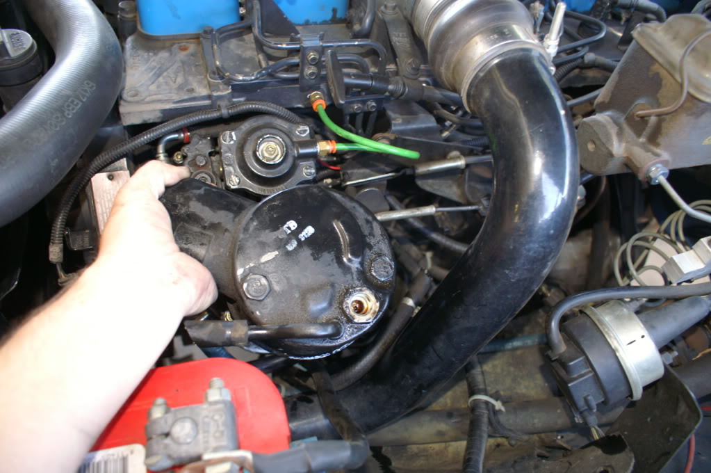

After you let all the excess fluid drain from the power steering pump remove the top bolt holding the vacuum pump to the gear case and pull it out until the gear clears the housing. Drop the front down and pull the back up a bit.
Then finagle it out the top.

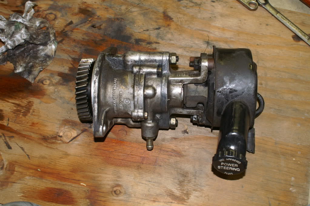

Now remove the 3 nuts holding the power steering pump to the vacuum pump. There are 4, but one is removed when you take off the small support bracket. The 2 studs on the passenger side of the power steering pump have spacers.

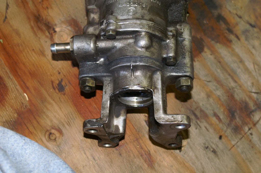

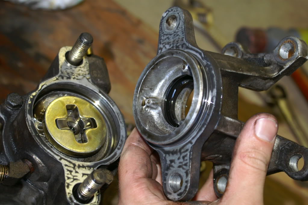

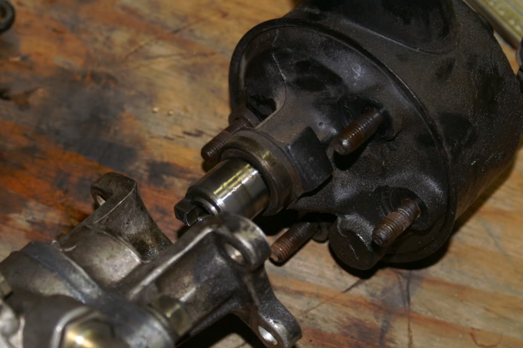

You may need to tap it apart with a small rubber hammer. Inside there is a drive star that turns the power steering pump. The o-ring on this part is the one that you have to stretch to get on. Put a little oil on the o-ring. You can see here that this is the main spot mine was leaking from.
Next remove the 3 small bolts holing the next section together and tap it apart and replace the o-ring.
The one in the kit is a little thinner than the factory o-ring, but seals just fine. Put a film of oil on the new o-ring.
Try to keep it as clean as possible. Now put the bearing housing back on the pump body and tighten the 3 10mm nuts back down.
Next we need to replace the seal in the rearmost housing. This seals against the power steering drive shaft. You can see it in the housing on the right in the picture below. You can use a socket to catch the lip drive it out and a little larger socket to drive the new one into place without damage. Lube the seal before install.

Next put the rear hosing back on the vacuum pump. Don't forget the drive star that turns the power steering pump. Then tighten down the 2 17mm nuts.
Next do a visual alignment of the power steering shaft and the drive star in the back of the vacuum pump and mate the 2 back together. You may need to turn it a bit to get them lined up. Don't forget the two spacers that go on the power steering pump studs. Tighten up the 3 nuts to hold it together and its ready to go back on!

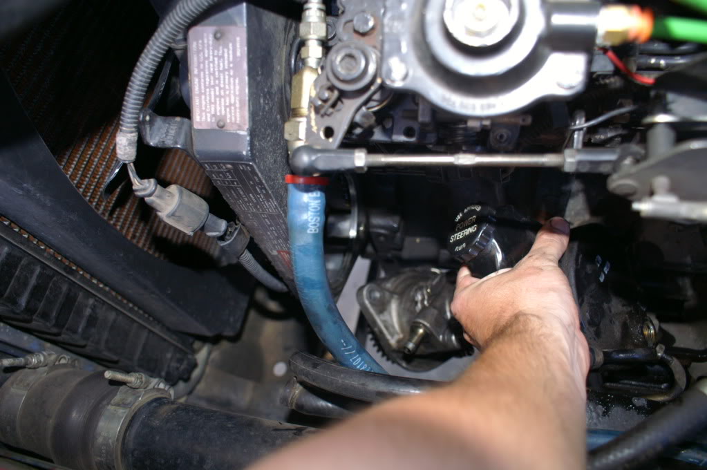

Putting it back on is just the reverse of removing it. The new gasket for the gear housing is not meant to have any sealer on it. I put a new o-ring on my power steering high pressure line while I had it apart. Tighten it all up, put some power steering fluid in it. (mine took a little less than half a quart) Fire it up and let it run for a few minutes and turn the wheel back and forth a few times to work any air out of the steering system. Shut it down and check for leaks. Now go inside a toss back a few!!
Here's a pic of it all put together.
Its not a bad job at all. Could be done pretty easily in an hour. I hope this shows some appreciation for all the help you guys provide me with!!
