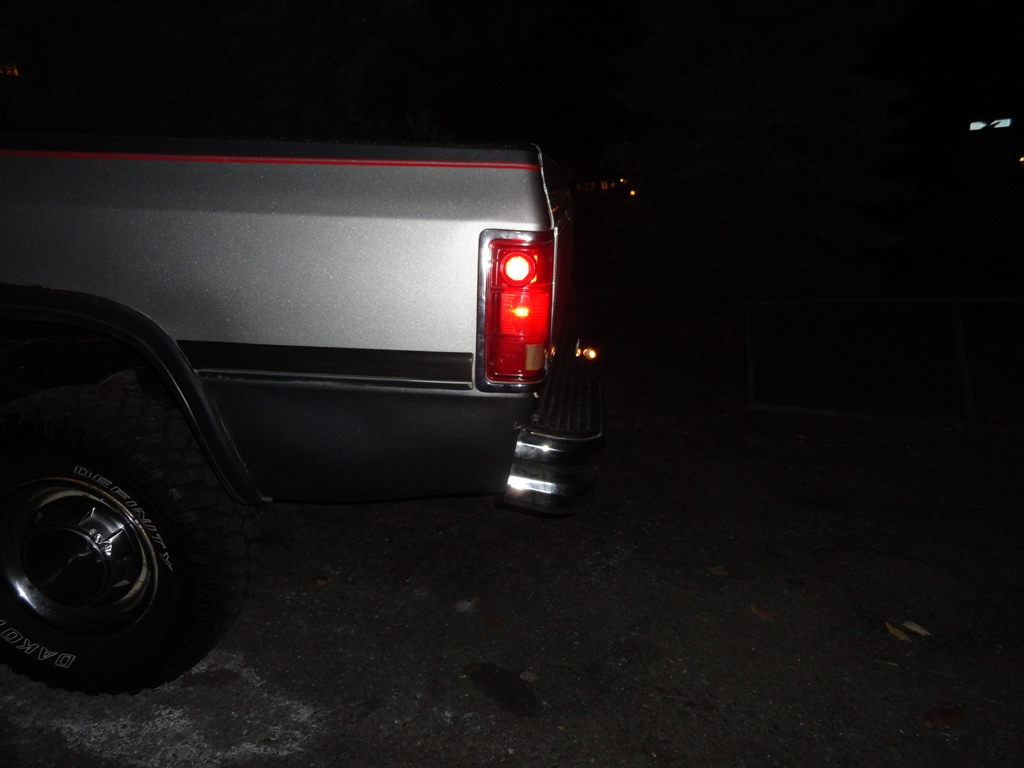

Was outside the other night, with my lights on, and I realized that you really can't see the truck from the rear that well, so as I'm looking for a set of LED taillights, I figured I'd experiment.
I had a 2" round (9) LED parking lamp, siting around, and I figured I'd install it on the truck.
Didn't want to cut a hole in the side of the truck, so for the mean time, I just stuck it in the taillight.
2 1/8" hole saw, and about 15 minutes, and what a dramatic improvement for others to see the truck at night from the side view.
I'm going to add a bunch of LED running board lights to the side, and maybe even permanently put a light in the rear fender... something flush and not that sticks out like the thumb lamp in my tail light... but it's good for now..
What's ya think ? Hate it ? Like it ? eh, who cares ?
I like the idea that I'm more visible @ night from the side, especially since I'll be plowing snow with it..

I don't really care for the look of it.
Ditto,
That's why I was looking for something more appropriate. My lenses are broken up, so I'm switching regardless. Looking to enhance them, considering there are no LED tail lenses available, AFAIK
