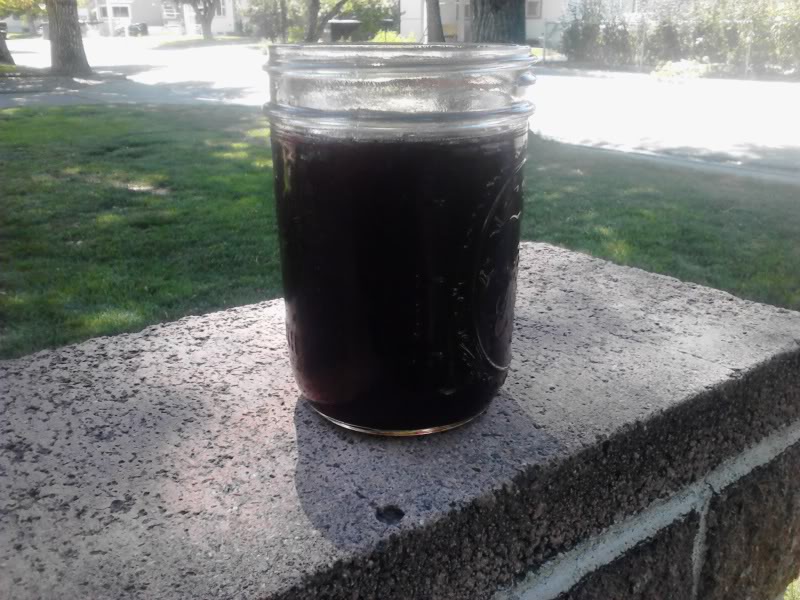

Here is a pic of some of the fluid. It is dark in large quantities, red if you pour it. Smells the same as it always does. It has 16,000 miles on it.
I am going to have the F2F put back in and new fluid done too.
