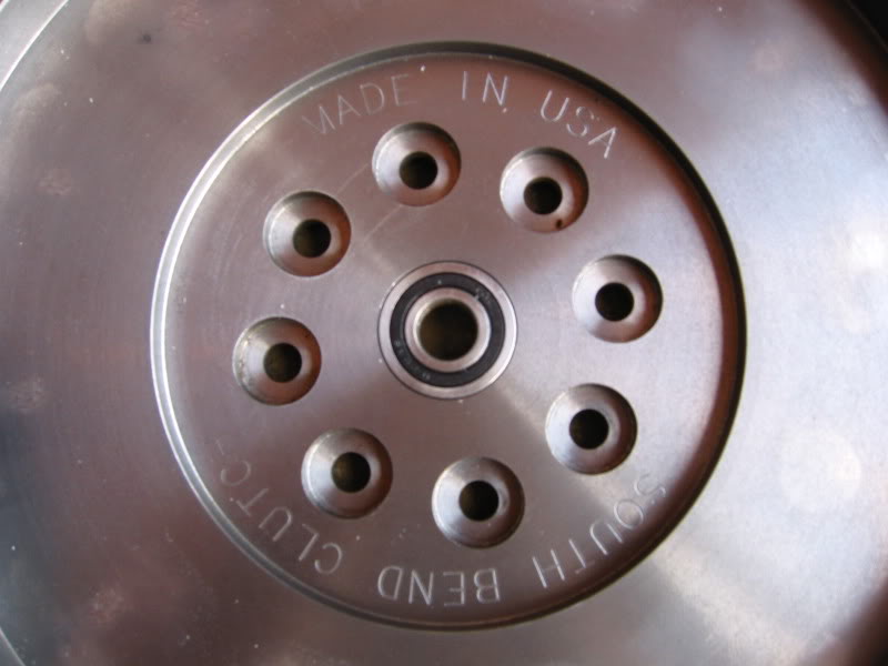

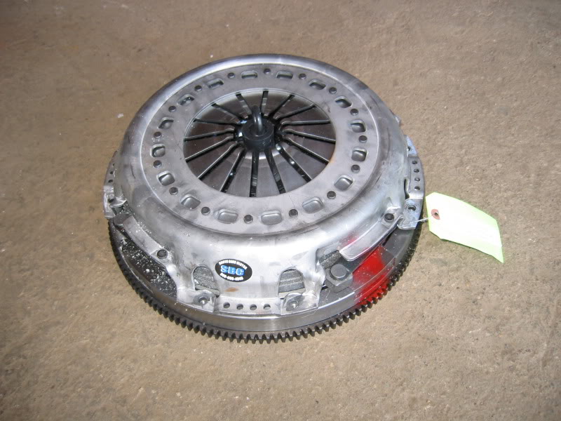

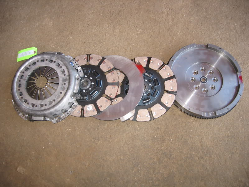

The '89 has a 3600# solid hub DD, it is smoother than the single disc Valair deal you were asking about. It was a direct bolt in. We did put a stainless clutch line on it. According to SBC some may require a little grinding to clear the bellhousing, and possibly a little tweaking of the clutch fork for clearance. They will give you all the details. Just tell them it is a 1-1/4" input.
Here is some pics of it: https://www.dieseltruckresource.com/...9-t244755.html
We also put one in for a friend, it is in his farm truck ('01 6spd.) It has spring hubs and is very smooth. It was a 3200# pressure plate, would possibly be the last clutch you have to buy if you don't get too crazy. If you watch you can pick one up new for around $1000, that's not too much more than a single really. They do rattle when disengaged, but that's a good reminder to not do it very long.
