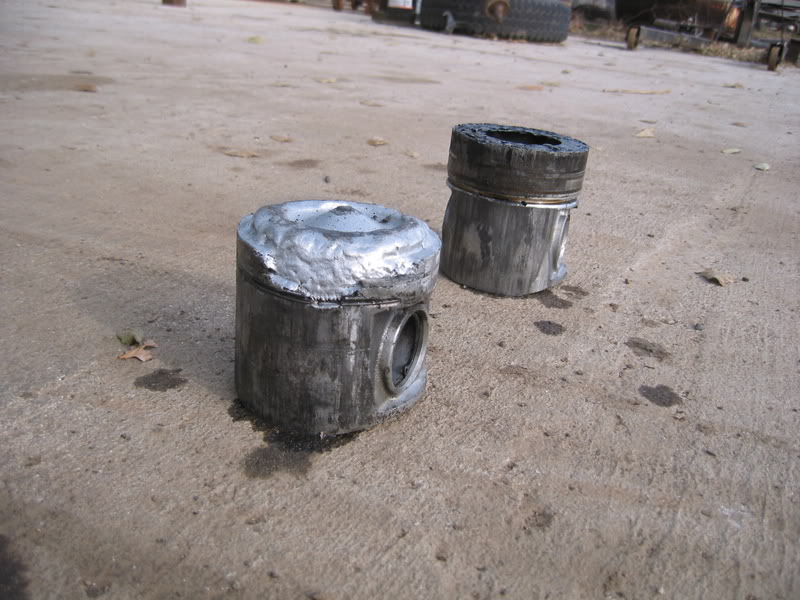

This is out of a VE 5.9 in dad's road grader. This was back when I thought pump work was voodoo. We had a shop redo the injectors and pump. They said a crack in the pump's distributor head was the cause, not the injectors. I do remember none of the nozzles were split. They replaced the H&R and rebuilt the injectors. He still has it and it runs great. Really wish we had got the old H&R back now.....

The plot thickens....
That's interesting, 'cause I though the injectors are capable of supplying only so much fuel. And if the injectors were good, why would that cook a piston? Fuel seeping past the seal? Mmm...
Sure did make a mess of that piston though.

Originally Posted by NJTman
So that pile is a molten mass of metal ?
Piston reformulation ? or head ?
T.
Its all piston.. Maybe a little bit of valve. Aluminum goes molten at around 930 degrees C. Steel at around 1370 deg C. So that piston would be long gone before there would be steel on that piston.
