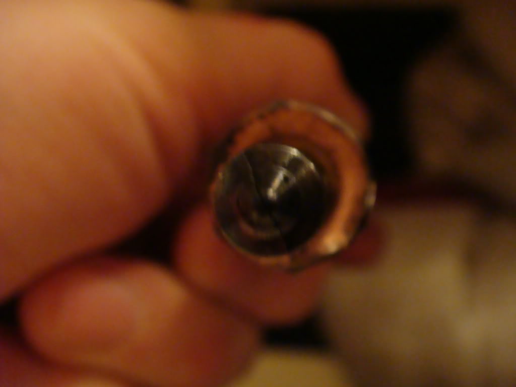

I also found the source of my excessive hazing
Six month old Scheid 6x16s.

Factory defect??????

At least it did not drop busted pieces in the cyl. Are they going to stand behind it?

The VE must put out too much pressure!

Sure do hope they help you out on that one. I think they say there is a 1year warrenty? And like Richie said you were luckey nothing broke off and caused real problems.

what were your egt's like in the 6 months

Ew. I'd like to see the spray pattern on the top of that piston.
Yeah that's the one good thing- I don't know if they're going to stand behind it, because I'm not going to ask them. I really don't want to deal with them and I don't trust them to work on my injectors.
Yeah that's what I was thinking
Anywhere from 0-1800 Actually once I got it tuned in 1500 was about max. Looks like I'm going to get some nozzles from Fletcher. He figured that they cracked from the heat cycles.

Looks like one of my 6x16's. One actually dropped the tip into the cylinder and another cracked a few months later. I'm afraid to take the head off and look, been many thousands of miles since and I'm not scared.
