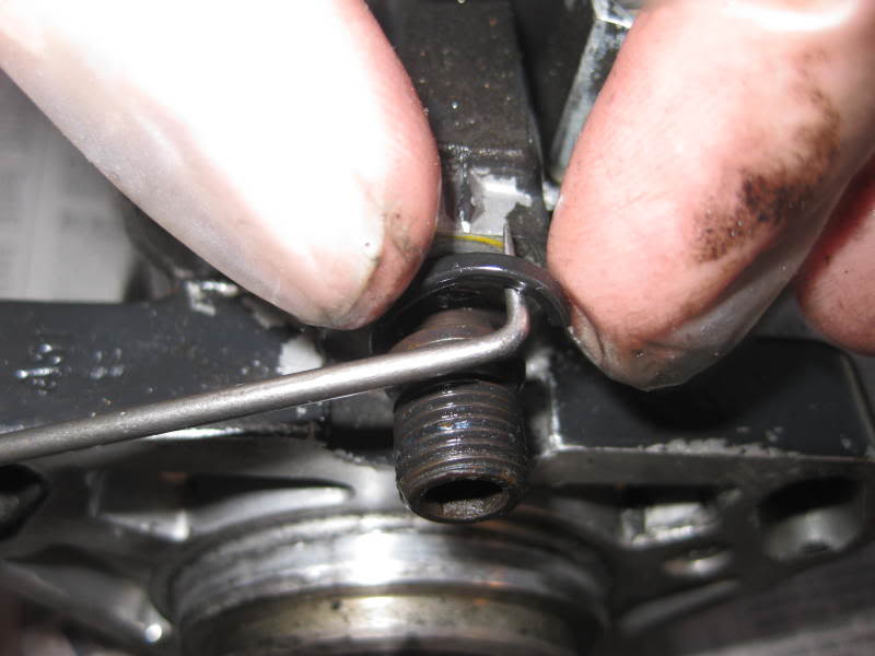

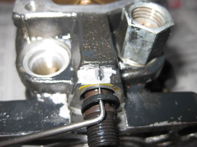

OK now you need to roll the new o-ring onto the governor shaft using care so you do not nick the surface, if you do then it will probably leak just like the old one, so be careful.

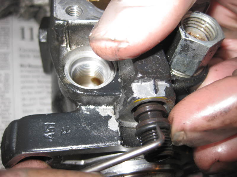

After you roll it up to the groove in the shaft you need to gently move it into the groove as I am doing here.

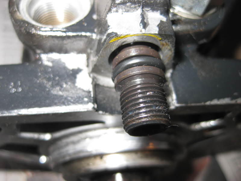

Now after you get the new o-ring into the groove you should very carefully using your pick, lift the o-ring out of the groove very slightly and encircle the shaft a few times to allow the o-ring a chance to straighten itself out incase it got twisted when it was being installed.
This is just something that I like to do, it would be like having tour socks twisted, it would work but it just won’t feel right.
Ok you have just repaired the leak on the Governor Shaft, all that you need to do from here is to first lubricate the o-ring (I use STP Oil Treatment) and then carefully screw it back into the housing till it is snug and then replace the washer and screw on the nut snugging it up with a wrench and then you art finished.
