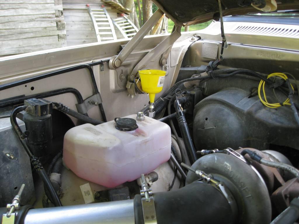

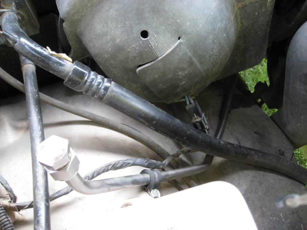

Update.
I was sick of having to crawl under the truck to change that tranny oil, even if it was every 2 years or so. It was congested, cramped, and awkward filling 5 qrts lying on your back. So I finally did this.
Yes, that's me filling up the tranny from under the hood. About 3 ft of 1/2" tubing with a couple compression fittings on either end. Some bending to do and whalla.... Works like a charm. Oil filled in 4.5 minutes flat. Clean and tidy, and who doesn't like stainless steel. I used a tubing clamp to hold 'er tight. You could add a dip stick if you choose to check level. I still used my plastic piece on the bottom end to verify oil in line.
