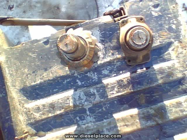

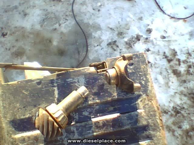

My 70 only lasted 7 hooks till it broke, like everyone else has said it all depends on how you use your truck. I am not very nice to my truck and the 80 is still holding up good after 25 hooks lots of burnouts and relentless abuse.(I guess I did break 1 d80 yoke) suprisingly I have never broke a 1410 u-joint, guess I'm not tryin hard enough
My broken 70 pinion
