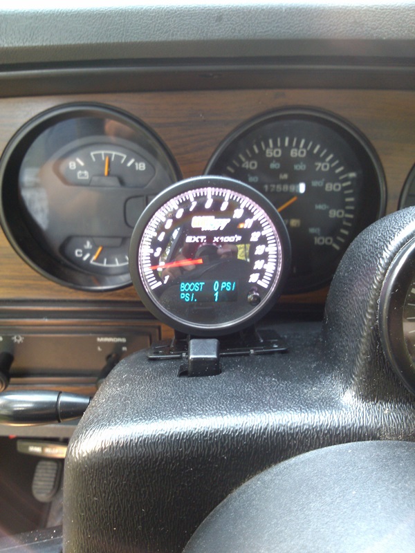

I kind of like the white numbers on the gauge. Seems to be the most visible for my old tired eyes.

You are only getting 1 PSI of fuel pressure at idle?
Or was the motor turned off?
How is checking out your speedo behind those gauges?

Is your idle speed 2K?
Old Jul 23, 2013 | 11:26 AM
  #51
Posts: 7,294
Likes: 2,884
The 2 K is his exhaust temp. reading, which if he just fired it up sounds about right.
The tach. is to the right and just out of sight.
That was when I just shut the truck off (1 psi). When idling and driving, it fluctuates between 3 and 4 PSI, but never higher.
Speedo is ok, as the only part you cannot see is from 0 to 25- 30MPH. I can still see everything else except for 75 and higher...
