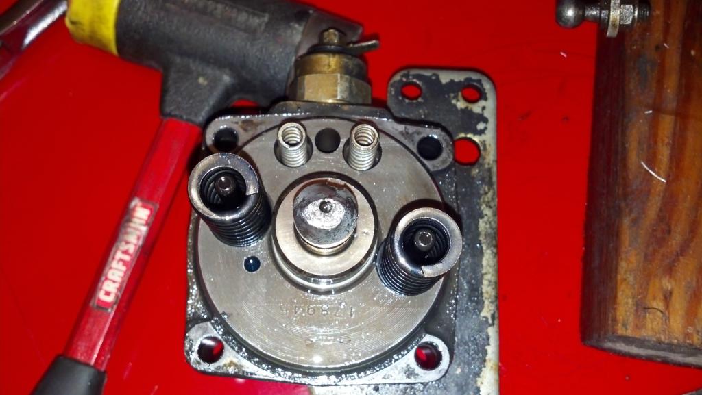

93-12Smoke's Avatar
Posts: 1,751
Wish i would have had one. May have saved me about $1500.00
Attached Thumbnails How important is the fuel pressure gauge?-2012-12-31_12-36-12_665.jpg
Old Jul 11, 2013 | 12:08 AM
Rick 12v CTD's Avatar
Joined: Oct 2008
Posts: 1,591
Likes: 11
From: Thunder Bay
ouchies.
That's exactly the point I was making too. Only a transmission is a bit more expensive!
At this point, if I was doing things over, I'd rather lose the trans because then it'd be an excuse to build it properly.
An IP... not so much. that's money gone in the wind.
Old Jul 11, 2013 | 12:15 AM
93-12Smoke's Avatar
Posts: 1,751
Yeah, broke the bolts holding the head and and pushed it out warping the case making it no good for a core.
Old Jul 11, 2013 | 12:18 AM
93-12Smoke's Avatar
Posts: 1,751
Installed a fp gauge with the new pump and i was making a whole 6psi at idle. No wonder it spit parts at the end of a 100 mile pull with about 22,000 lbs.
Ive busted a nv4500 too. That was also expensive!
