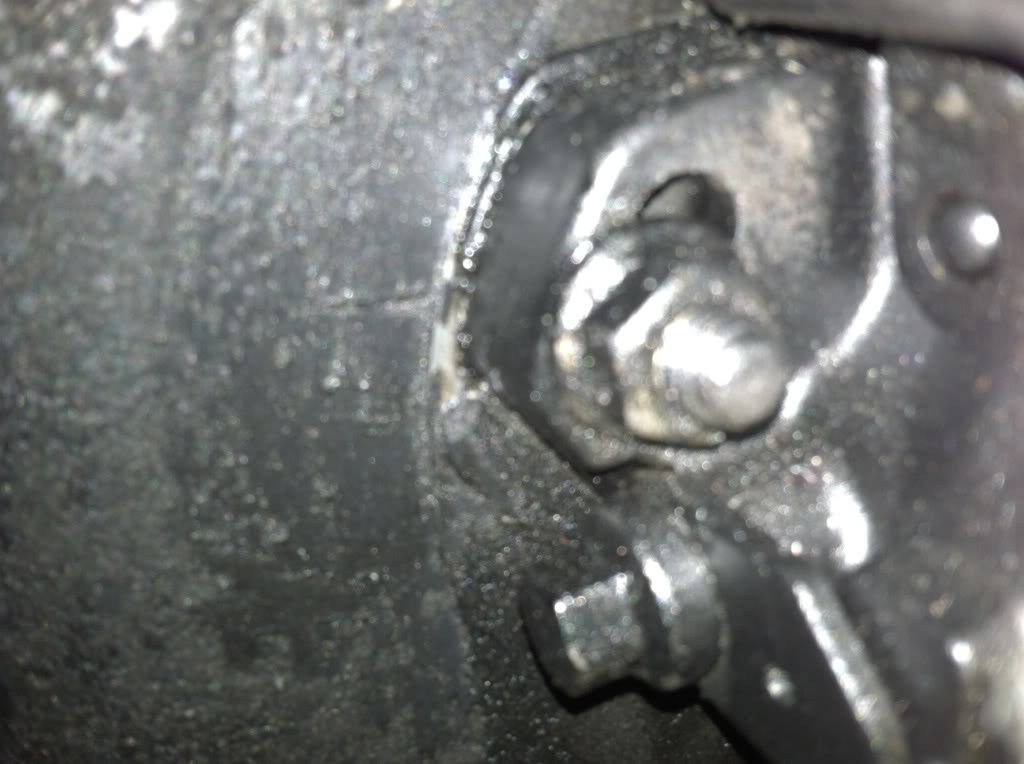

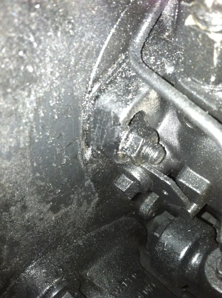

Timing marks
I had someone else do the timing on my truck a year or so ago. I always thought it was to the head becaise my afc housing(when i had one) was very close to the head. I am getting prepared to put the timing back to stock just in case what i have now and the spacer will be to much. The mark on my pump is not there? U can see the mark on the timing case clear. What do you guys think my timing is at? Think i can run this and the spacer? Wheres the beat place to get a wrench to do the job? Etc etc. please tell me what you think and know anout all this...

looks like a newer pump, my new one doesn't have a timing mark on it yet, i think your supposed to do it when you install it at tdc. I've been thinking about this mod for awhile but idk if it would be worth it for me.

Dosent help that i painted everything under my hood...
