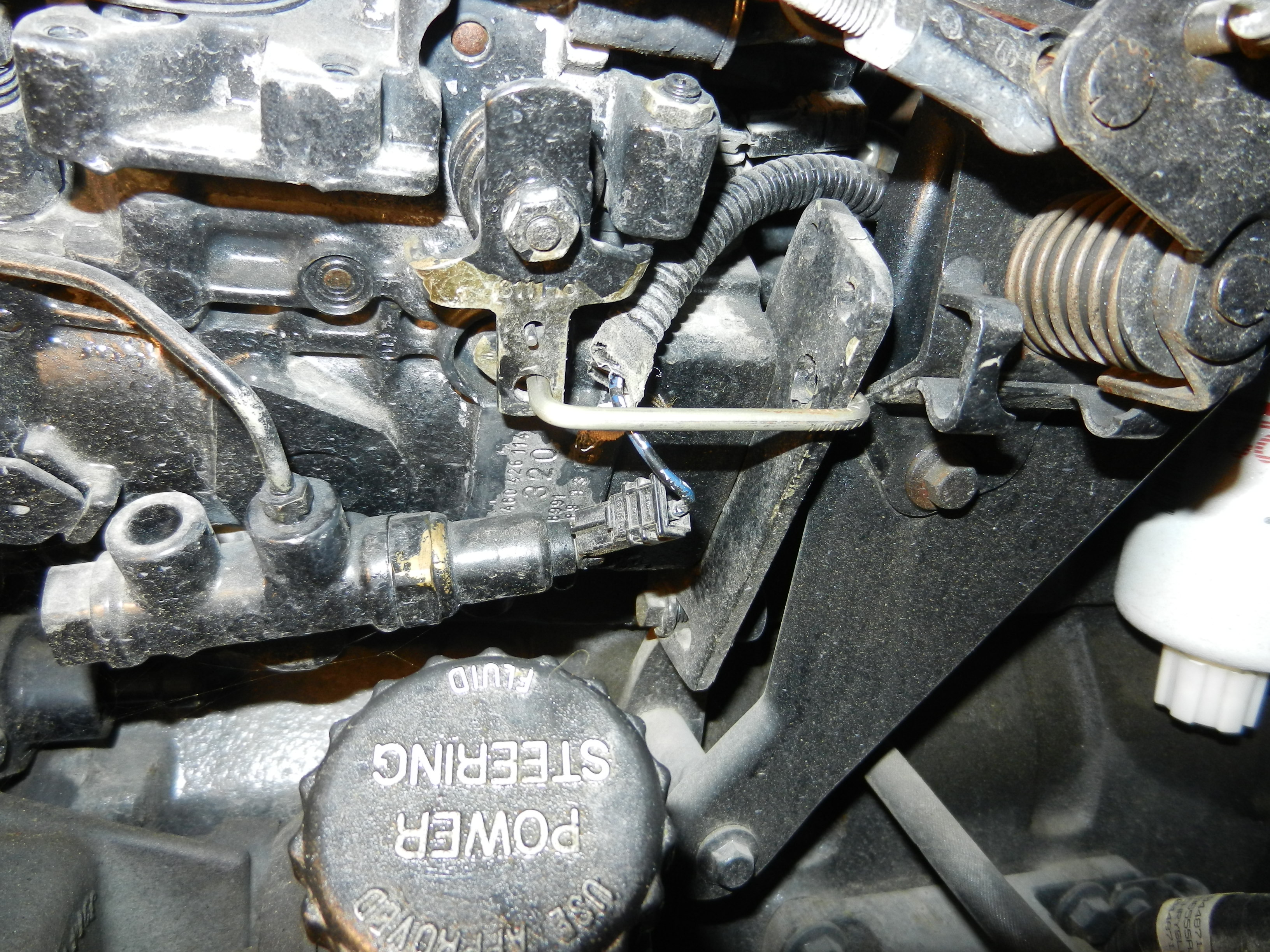

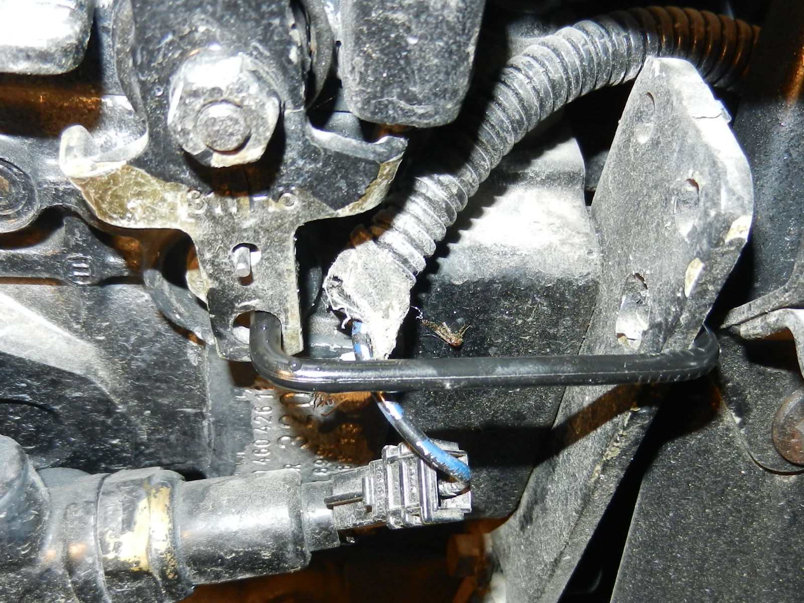

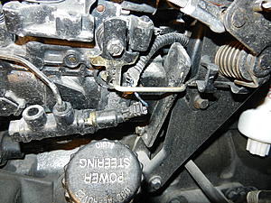

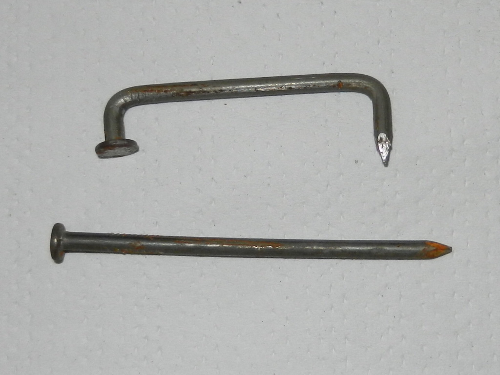

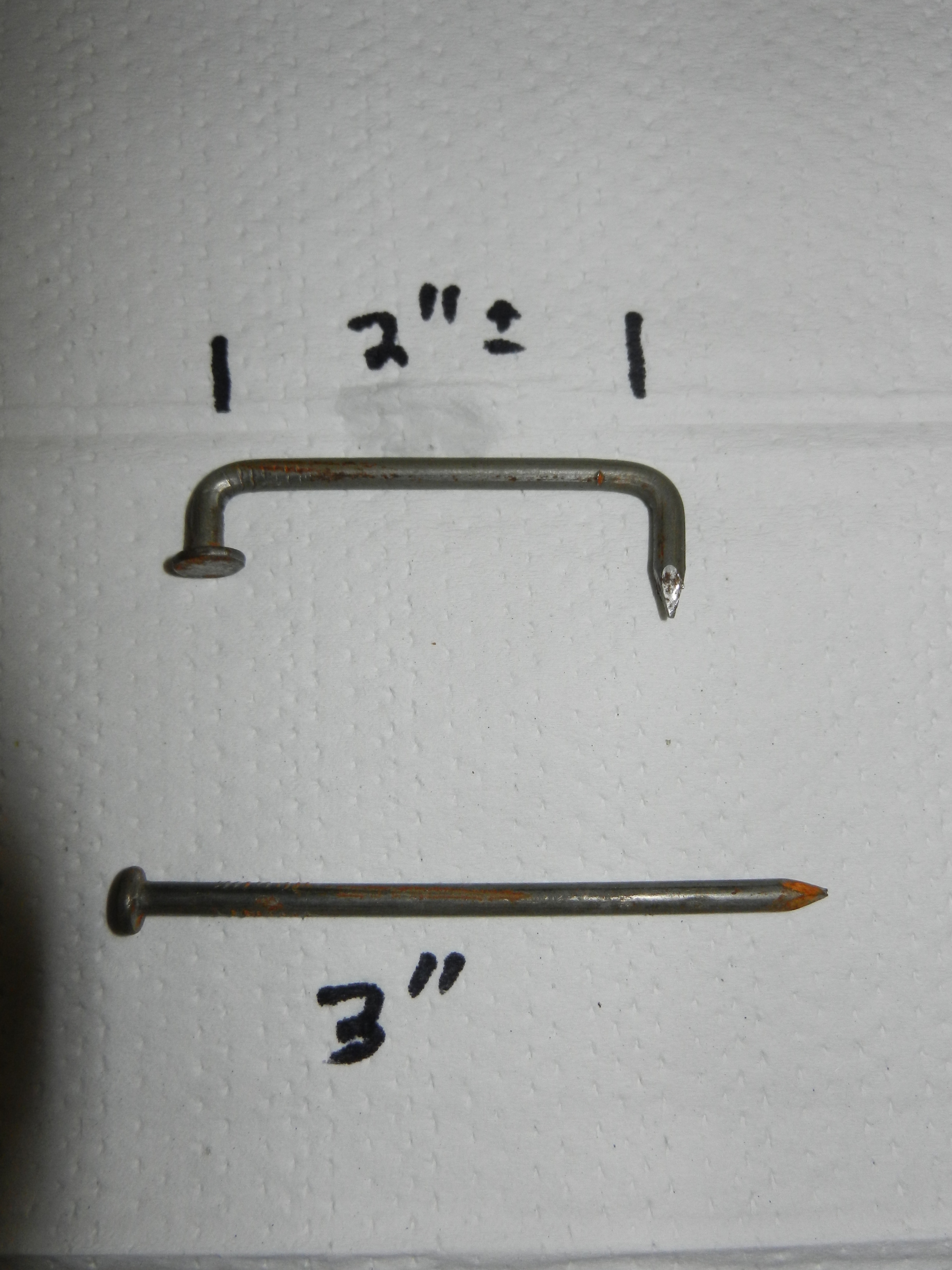

Try making one of these.... A hidden bent nail that holds the fuel shutoff closed. An average person would think its part of the linkage, and it only cost a penny!
