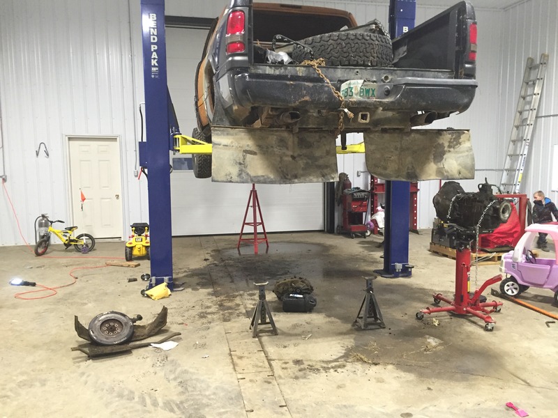

Bringing this back from the dead, I yanked the transmission and clutch out of a 98 12v to use behind my 93 12v in the flat fender. The entire clutch hydro assembly off the p pump motor is no good and neither is the starter.
So I need a 94-98 12v Manual trans starter? Will my getrag slave work on the nv4500 bellhousing?

I'm doing a getrag to nv4500 swap now.
if you use all of the 2nd gen stuff, the slave will work, but you have to turn it around to face the opposite direction. this puts some strain on the line, but it will work.
you'll also need the 2nd gen starter

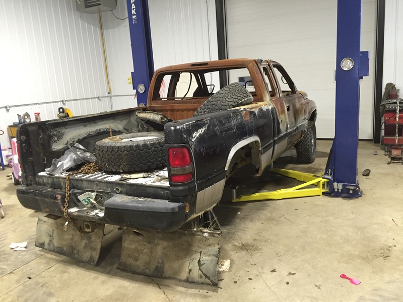

Ok I will try it, I think maybe my master is a bit further from the trans Then a factory 1st gen would be. Thank you for the reply
The cab had burnt off this 98 so I'm hoping the trans is ok. Going to take off the pto covers and look inside. Back up light plug is melted, shifter boot is slightly melted. I really don't think it got hot enough to hurt the internals though
