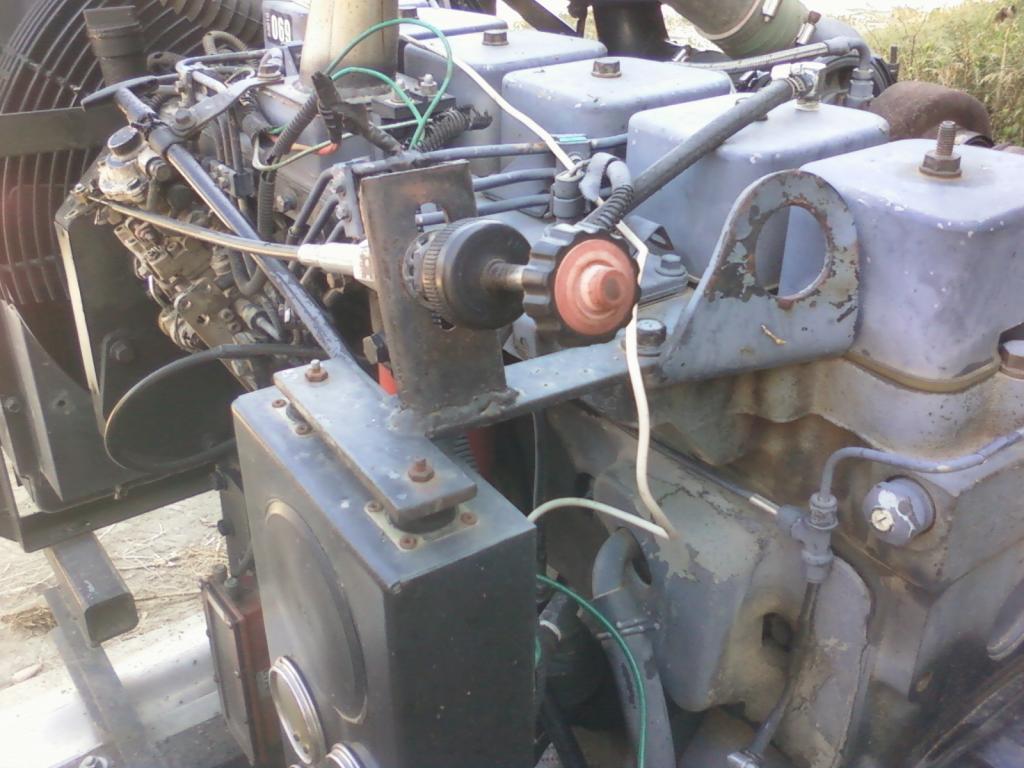

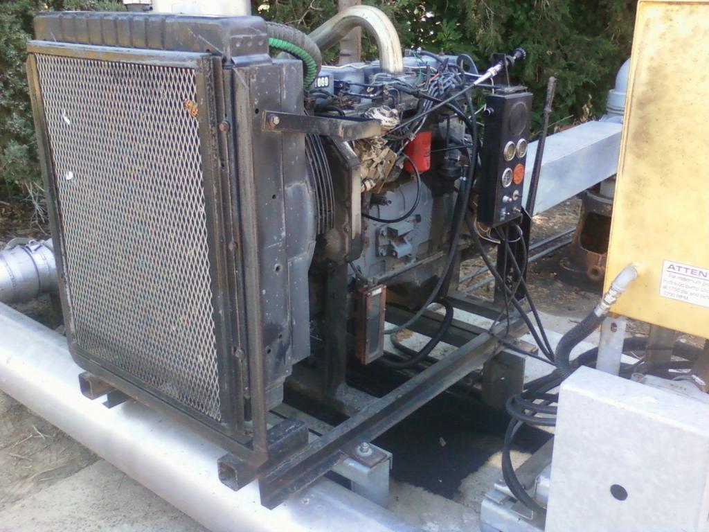

Hi, I haven't been on here in a while with a question but I have a 92-ish 6BT on an irrigation well and pivot that came out of a Dodge pickup. It has been running well but when I checked it tonight the RPMs had slowed a little and I thought the throttle may have moved. I adjusted it fine and just a couple of moments later it died just like you hit the kill switch. It would not start.
I got a new fuel filter and put it on an hour later and still nothing. I checked for 12V at the inj. pump too. I bled the injectors and they squirted fuel fine. I sprayed some WD-40 into the turbo intake and a little smoke came out of the exhaust but it doesn't even try to start.
Do you have any ideas of where to look and what to check? Have to get it going as quickly as I can. I do have some parts trucks to rob parts from.

I forgot to add that a couple of weeks ago the nuts that hold the injection pump came loose and I tightened them up and it ran fine before, during, and after that.

Good news! I had a service tech come out to help because the way my luck is on the farm this year----I knew the pump would be coming off!
We gave it a whif of either and it came to life but did not stay running, took an injector line clear off and it had a little fuel, but not enough to run. Lift pump was working. Took off a bracket to get to the FSS and it was tight as usual to turn it. The plunger looks perfect but the o-ring inside looked bad. Put it in without the plunger parts and it fired right up.
I had a new FSS on hand and we put it in and all back together and it is running fine.
Could the bad o-ring let fuel leak where the spring is and not let it open all of the way?
I'm glad I did not have to pull a good pump from another engine to get going as getting mine rebuilt would have taken a week or more. Everyone is very busy right now.
Thanks for all of the help here!!!! Now I need to find where I ordered the cheap VW FSS and get another one on the shelf.
On another note, my Duetz locked up after decades of good service and I just yesterday put a p-pump 1994 on another well. When the truck wears out, keep the Cummins spinning!
When I took these pics, I still needed to add fuel lines and a power shaft cover. Safety first....
