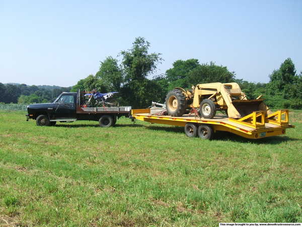

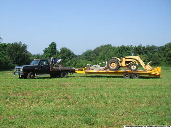

This is the load I hauled this past weekend, minus the 4 wheeler. With the new mods she went up the hills in 4th or 5th at between 48 and 60 mph. The EGTs most of the time were around 1250 to 1350. On the long, steep hills the temp would go to 1400 and a few times started into the 1500s before I backed off. Do I have to change my driving tekneek or is there some fine tuning I need to do? Or is this normal and OK? Any info is greatly appreciated.
