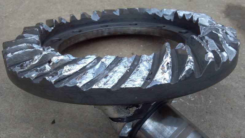

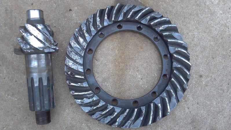

We got it finished up Thursday, and they let us pull exhibition at the county fair "big boy" pull that night. Somehow, the air shut off got tripped twice in a row. This lead to the ring and pinion getting trashed. Vids are coming on that one.

Luckily, we had spare 3rd member and got it fixed for Saturday. Made a couple passes at Leon, IA. Matt had a pretty smooth run in the 8000# and went 397'.

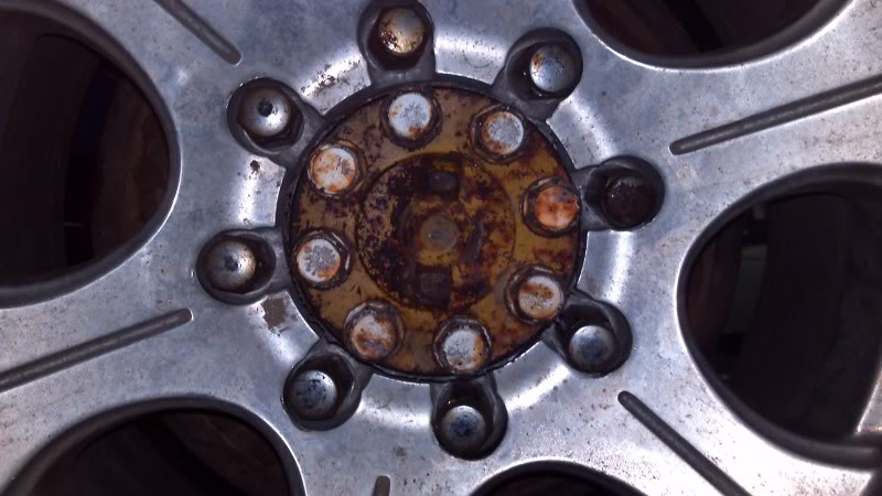

Somewhere along there we torqued the wheels studs on the rear wheels. Kind of hard to see in the pics, but all the studs are angled now.

wow that things a runner! I wonder if its the 1/2" studs that are the problem? thats pretty crazy, can't say i've seen that before, you must really have some torque and really getting some bite on the track.

Well, turns out they were 1/2" studs in the back. They are 9/16" now. Got a pump back on it, too.
