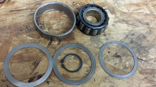

Ok getrag people give it to me, how bad is it?
I noticed my truck slowly leaking fluid which looked like it was from the trans. It looked like it was coming from the point that the transfer and mount/tcase adapter bolts together. I found all the bolts to be finger tight or slightly tighter.
Pulled the adapter off and the snap ring for the bottom shaft was laying at the bottom. You can see the shims have been spinning. I worked the bearing off, not sure if it is supposed to be a press fit? I assume not since that is what the snap ring is for?
Now what's my course of action? Pull the trans and rebuild or?

The bearing is pressed onto the cluster shaft yes. The snap ring is supposed to hold it on too. Looks like not enough pre-load maybe? I'm not a getrag expert but have 13k on the rebuild I've done.
You need to pull the trans to get the cluster shaft out. I'd do a full bearing rebuild while I was there, and synchros if you need them. Wouldn't hurt to do the input shaft as well.
Was it making any weird noises?

Pulled it apart and it's minor damage, basically some scratches on the outer most bearings/races and the counter shaft surface. The inside of the counter gear has no scratches felt by fingers, the counter shaft itself though does.
Manual says you can clean up the shaft with 3-400 grit emery, not sure if that will do it though.
What's everyone's thoughts?
I am planning to change all the outer bearings/races (main and countershaft each end) aswell as possibly cleanup the counter shaft and reuse it.

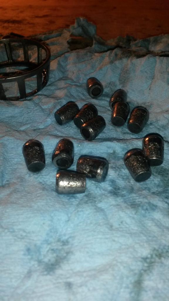

Sure glad I decided to re - bearing the whole thing. This is the rear main shaft bearing.
Pulled the main shaft apart and checked all syncros, look great.
