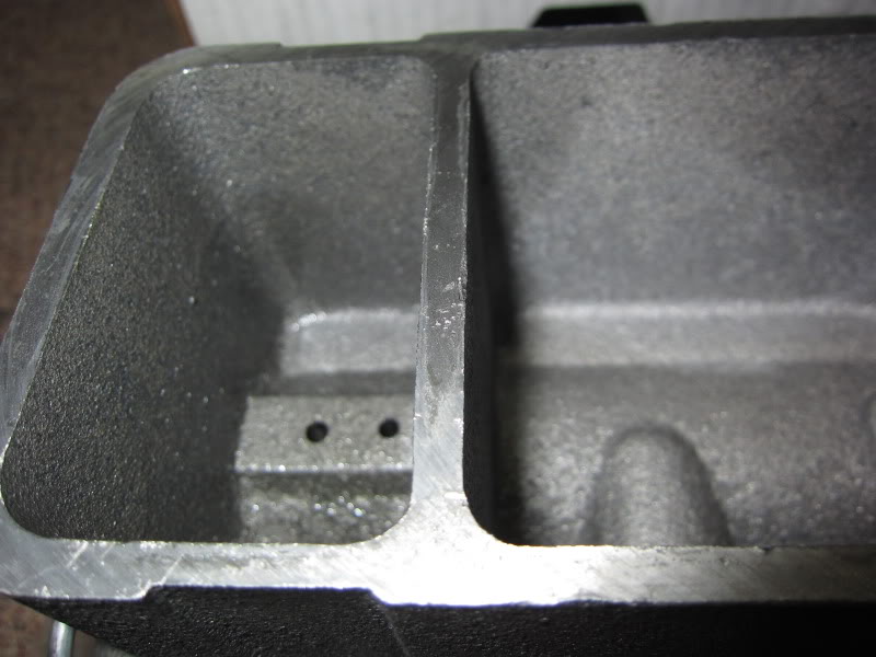

I cleaned it up and popped the cover not knowing what to expect and found the fluid level where I had left them about 1/2" below the top on both sides.
I drove home about 5 miles and came out and checked it again and found the bottom of the master cylinder dripping with fluid again???
Looking at the cover I removed the rubber gasket and the inside of the metal cap was also wet with fluid, the wire bail that secures the cover is tight and you cannot move the cover once it is fastened down but still the brake fluid is escaping.
I did notice that the top edge of the master cylinder where the gasket sits if all nicked and beat looking and is probably where it is leaking from.
This master cylinder looks like it has been dropped or tossed in a big pile of other cores where the sealing surfaced have gotten all banged up and someone grabbed it and replaced a few parts and called it good.
I didn't think I would have had to check the surface before I had installed it.
Today I am going back to NAPA and tell them to give me another one and I will be sure to inspect this one be for I leave the store.
This one was remanufactured by A1-Cardone, they also supply Pep Boys, Kragen, Auto Zone and a host of others.
One would think NAPA had a bit better quality part than Kragen or Pep Boys but I guess not.
http://www.napaonline.com/Search/Det...+50022+2022022
So what do you think, is this where my leak is comming from?

I've had 3 master cylinders from Napa (one on warranty) on my Dodges now. They all seemed to weep around the top!!! Like you said, level is still 1/2" or so below the top, wire bale is tight, etc.
I noticed on one of them that there were little flakes of metal embedded in the rubber gasket!
On the last 2, I rubbed some grease onto the rubber of the gasket. I sprayed the whole Master/Booster assembly with brake kleen to wash off the phosphorous coating and gave them all several coats of engine paint. During this time, I think the grease softened the rubber to make it seal better. I now don't have the paint peeling on my master cylinder. Maybe give it a shot?

While working as a technician, I had seen so many rebuilt master cylinders with a rough sealing surface, that I had decided never to install a rebuilt master cylinder again. The same goes for rough gasket surfaces on rebuilt water pumps. Luckily there are now several manufacturers making NEW master cylinders these days, and the quality doesn't seem too bad.
I don't see how it would mess anything up if you knocked a couple thousanths off the top of the mastery cylinder and get a nice fresh surface?
Maybe check with a local machine shop that has a mill?

I put a light bead of GMS (General Motors Silicone) to the surface of the master after sanding it a little with some sand paper. Mine has no leaks now and it's full to the top. I'm guessing the new one you get will be of the same "quality" as the old one.
W.W.J.D.?
That is what I was going to do when I got my replacement master cylinder, I used to do this when I worked on V-730 and Allison Transmissions, I would lap the surface of the valve bodies on a large piece of glass and a piece of 800 or 1200 wet/dry paper or crocus cloth face up.
The only concern I would have doing it to my master cylinder is if the raw surface would rust but it would all be covered with the gasket so it should be all right.
You could do this on the truck if you had to after you emptied out the fluid and stuffed the reservoir with a rag just below the top then either with a piece of 1/4" safety glass (wear heavy gloves) or a sturdy block of steel of aluminum wrap some #180 wet/dry paper around the block and carefully polish it using an X pattern from front to rear, side to side.
After it takes the rough cut the paper will flatten out and become finer and you should end up with a nice flat surface.
I would then swab it out with a strong magnet to pick up all of the filings and then very carefully puff it using compressed air and then remove the rags.
Fill using fresh dehydrated brake fluid and bleed them till you get a few ounces out of each cylinder.
This should stop any leak that might come from under the lid.
This is just what I would do.

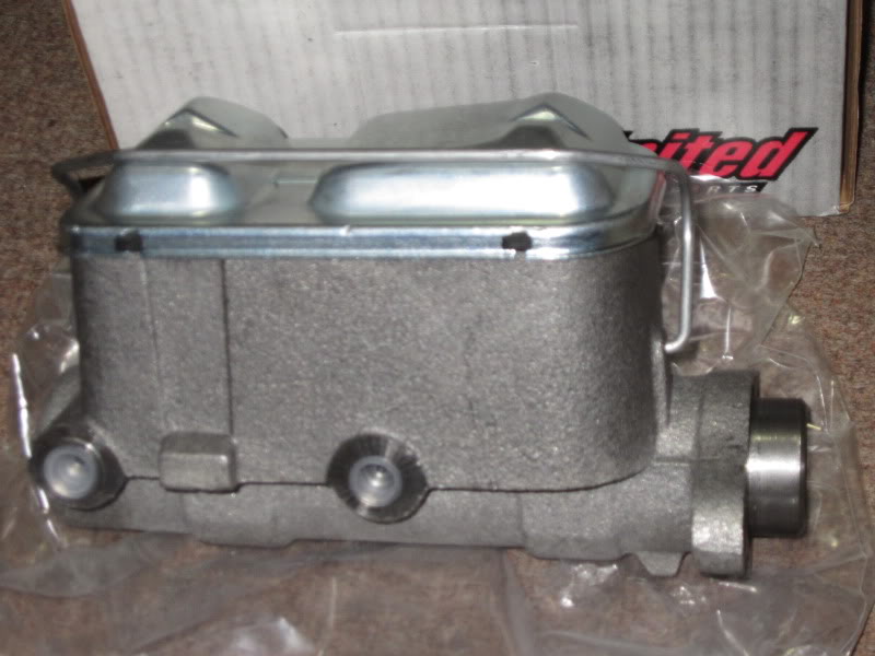

So after all of talking and whining, I wound up with a Remanufactured Brake Booster and a NEW Master Cylinder all for the original price and all with a lifetime warranty.
Now as soon as it stops raining AGAIN I will install my new master cylinder and I will be happy.
Here is the number for the new one:
Check it out..
I am going to check this on a piece of glass before I install it just to make sure.
I don't think I will have any leaks with this one.
