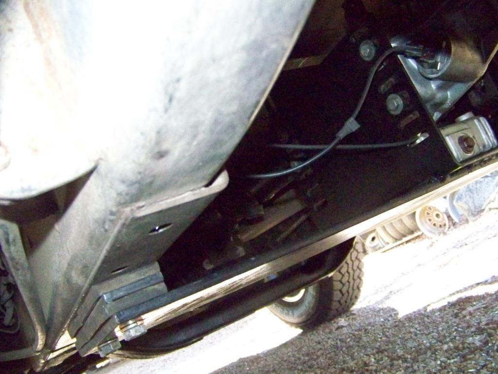

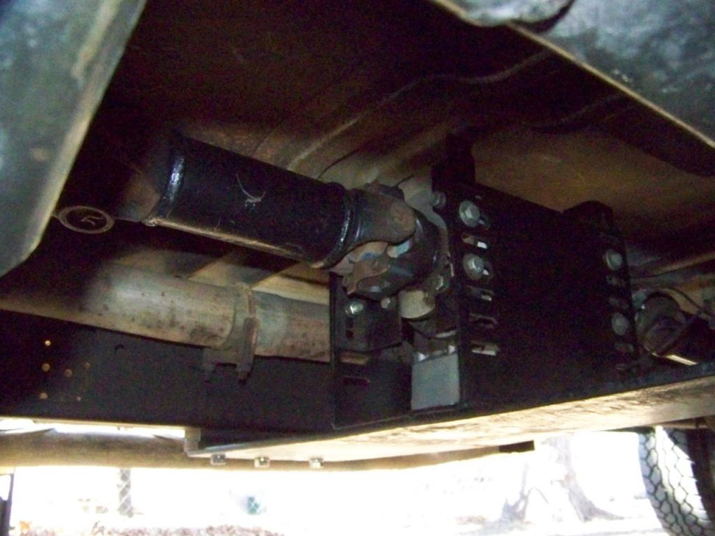

Gear Vendors pics
Here's a couple shots of the mounting for a divorced Gear Vendors. You can also mount them straight onto the tail of the trans with the right tail housing adapter. These are really straight forward. Just have to have drive shaft adapted or new ones made.

On my truck I did not divorce the GV. Mine bolts on to the T-case. Is this going on a single or ex. cab?
Old Jan 3, 2012 | 07:23 AM
BILTIT's Avatar
Joined: Nov 2010
Posts: 2,205
From: Lloydminster SK/AB
Single cab and mounted to the tcase.
