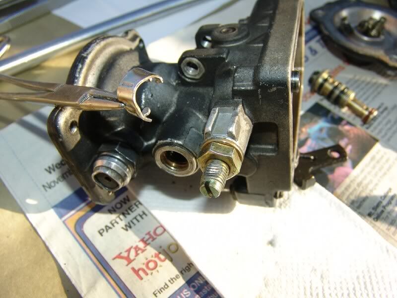

I've been searching but can seem to find anything. How exactly do I get a screwdriver in that space to mess with my full power screw. I plan on backing it all the way out to take the collar off, how?!

On the intercooled trucks you can use a 6mm socket and a ratchet.

Loosen the jamnut with a 13 mm wrench , then use the 6mm socket to back the screw out.

Originally Posted by Begle1
So how do I do it on my non-intercooled truck?
If I remember correct, an open-end 12mm wrench and a long shaft straight screwdriver of medium size.
The open-end wrench works the lock-nut and the screwdriver adjusts the fuel screw.

begle- i have a screwdriver that's about 12-14inch long that i slide up from the back, works great!

thanks for all the help guys. I took the whole screw out and broke off the collar, doing my best to keep the jambnut in the same spot. I put it back in and turned it probably half a turn at best, then tested it for today as it was getting dark outside last night when I was working on it. Well, I went out again today and gave it another half twist. Gonna see what happens, then might add one more then I'm done. I swear!
