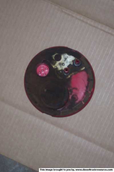

ofcmarc good pic in the link.
now shouldn't there be a hose connected to the roll over valve?
Old Aug 8, 2009 | 08:05 PM
Free89W350's Avatar
Posts: 1,540
From: Pen Argyl Pennsylvania
Here is a pic of the one in my truck. There are only the two hoses the "rollover valve" didn't have a hose on it. The 2 fittings are at 2 O'Clock and the rollover valve is at 6 O'Clock and the plug for the level sensor is at 11 O'Clock.
IDK. It's BC's Pic and he had the tank out of the truck at the time. There might have been a hose on it before he dropped the tank......
Old Aug 9, 2009 | 11:21 AM
comptz's Avatar
Posts: 495
From: southern Indiana
when i had my bed off there was no hose on the roll over valve, just a vaccum cap closing it off. And all that i know it has never been touched.
