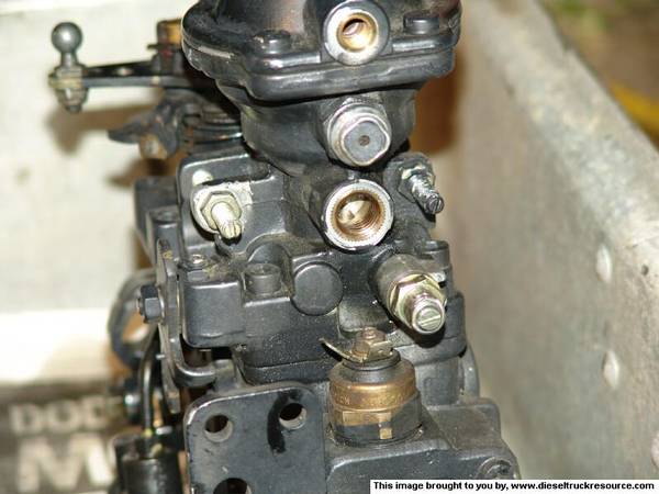

When I turn in the Fuel Screw for more power, the Idle goes up with it. How do I turn the Idle back down?

There is an idle adjustment screw between the head and the afc housing on top of the injection pump.

Farmboy, you can use a small punch and a hammer to break the jam nut loose on the idle adjust screw. Just as Bill said, it's between the head and the AFC housing. In the following picture, you'll see it above the fuel screw that you turned up.
